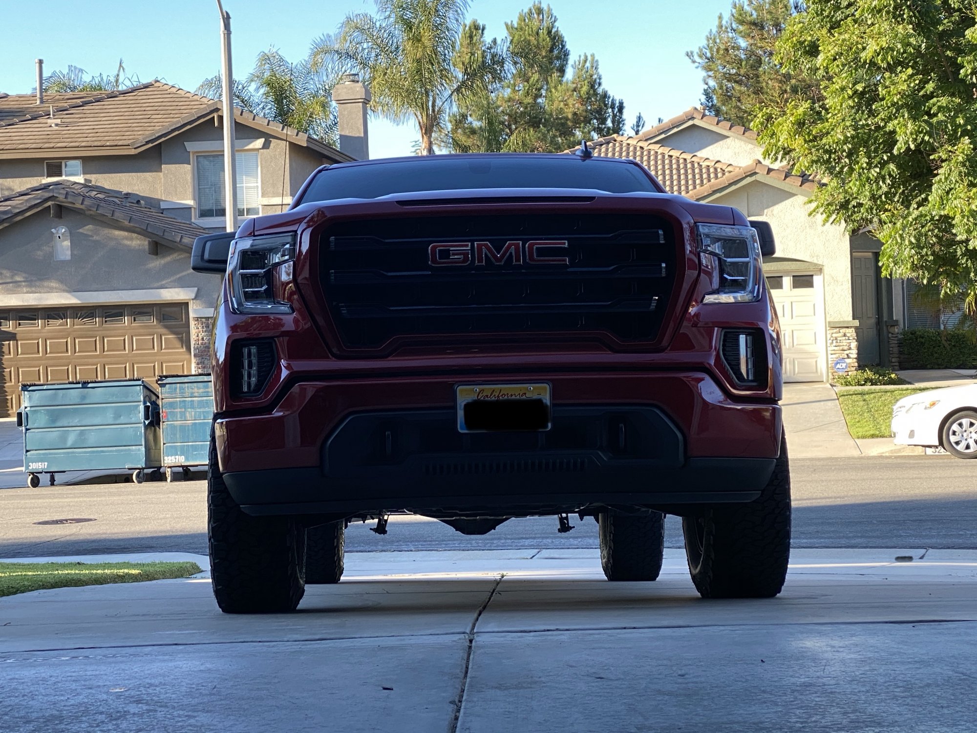

285/55/22 nitro ridge grapplers. This is the exact look I was looking for. Traded in my 2019 4runner for this 2021 GMC Sierra Denali and really dig the 6.2!
Is that stock suspension still?  It looks like its been leveled ?

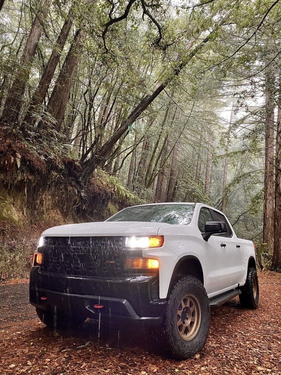

image0.thumb.jpg.6ade54f7f9465048799c3fec366f240b.jpgStock truck, 17 inch wheels
Which wheels are these? i'd like to see a few more pictures. i was stuck between 17 or 18s for my AT4. I want the offroad look but tire availability may dictate which size i go with.
Method 312 bronze 17’s. Better check with manufactures before you order 18’s.  They would work on my truck due to the convex.  The raised rail on the outside of the brake calipers disqualifies a lot of wheels.  Not sure if the AT4 has the same or not

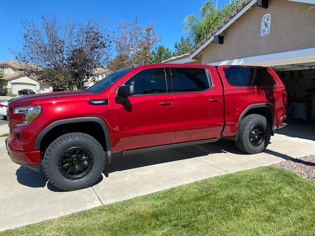

 I just got a killer deal on some 20x9 -20 wheels, I currently have stock 18” wheels. RST, stock suspension.
My question: with the offset I should stay with a stock size 275/60/20 correct? Seems like anything bigger with the offset I’ll rub

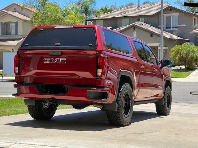

On 7/19/2020 at 3:20 PM, N2HighVoltage said:
2020 GMC SIERRA 1500 4X4 CREW CAB 3.0 Duramax
Front: FOX 2.5 Coilovers front (3.5” of lift)
Rear: Deaver mini pack w/FOX 2.0 (1.5’-2” lift)
Wheels: American Racing AX202 18x9 0mm/5.0” backSpacing
Tires: BFG K02 35x12.50x18
Trimming required...good instructions adjust based on your needs...no rubbing now.
186318
Looks great!  Did you get the Deaver AAL that is on their site or did you use the one from Cognito?
ALso, did you do UCAs up front?
Thanks in advance.

Yeah I tried that size, but didn't really want to trim anything so I replaced them with 275/55's.  I'm thinking 275/60's would have worked also.

I'm slightly rubbing with 20x9 zero offset, 275/65/20's, & 1in lift front but in reverse only.
Are you Stock height or lifted? I'm surprised to see no issues on a 285/55/22 with the stock +27 offset. Any trimming or rubbing?
I do not believe that is stock height
