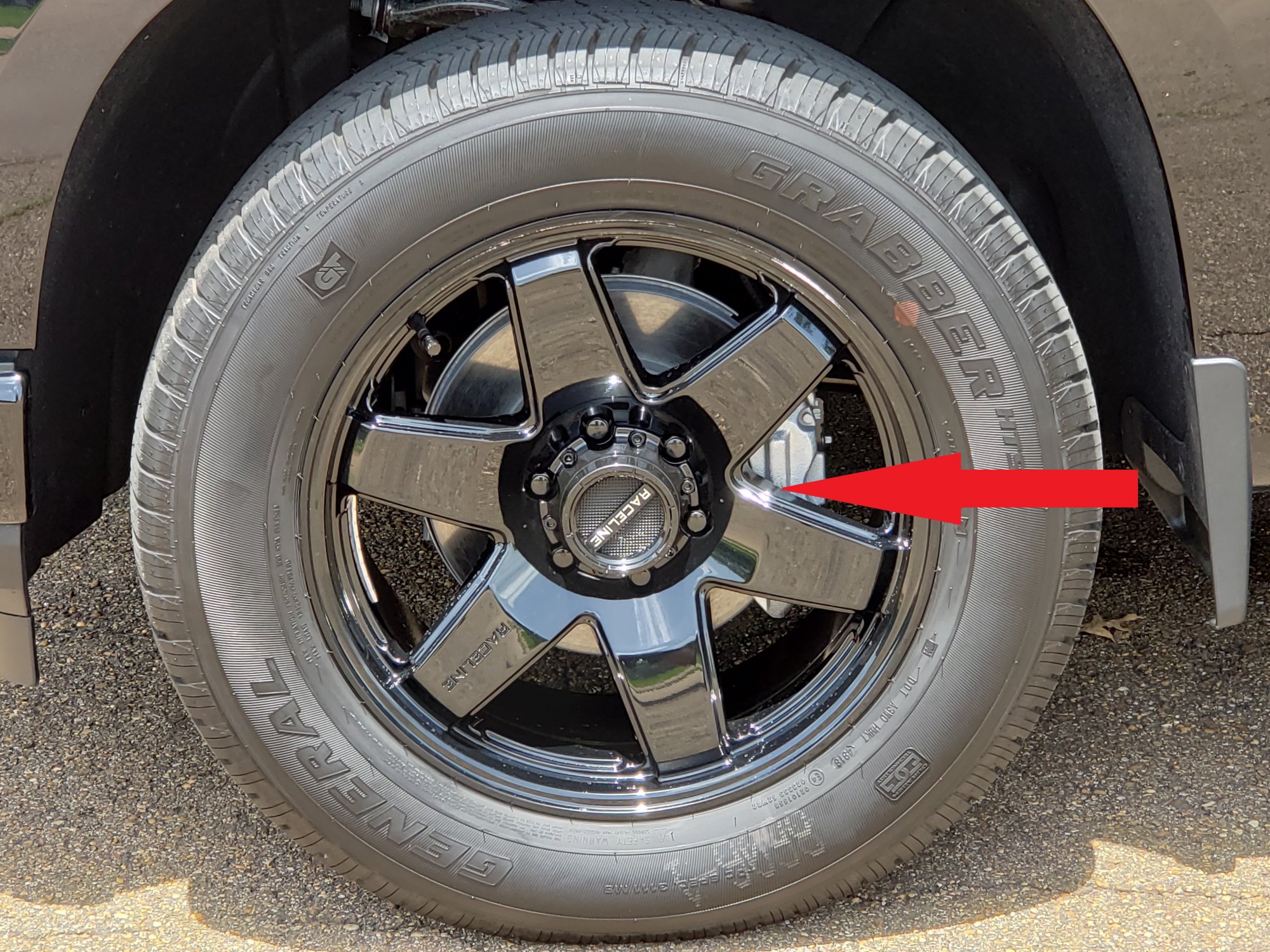

On 7/31/2019 at 8:32 AM, KEEPER OF SECRETS said:
Mine is a rwd Custom that came with 20x9 wheels and those tires.
The only thing I changed were the wheels, lug nuts and hub centric rings.
Wheels came from Custom Wheel Offsets.
Offset might be the only thing to check out on yours, depending on tire choice.
Maybe some other 4x4 owners will chime in with what will work, tire size and offset, w/o rubbing or other issues.
The main thing is this. Some wheels will require spacers, due to the redesigned front calipers having a molded in bump in the center, that require more inside contour of the rim to clear. TMK the previous Gen didn't have this bump. See attached photo.
These have plenty of clearance w/o spacers.
Wonder if anyone has ever filed that bump down?

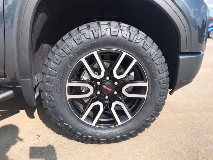

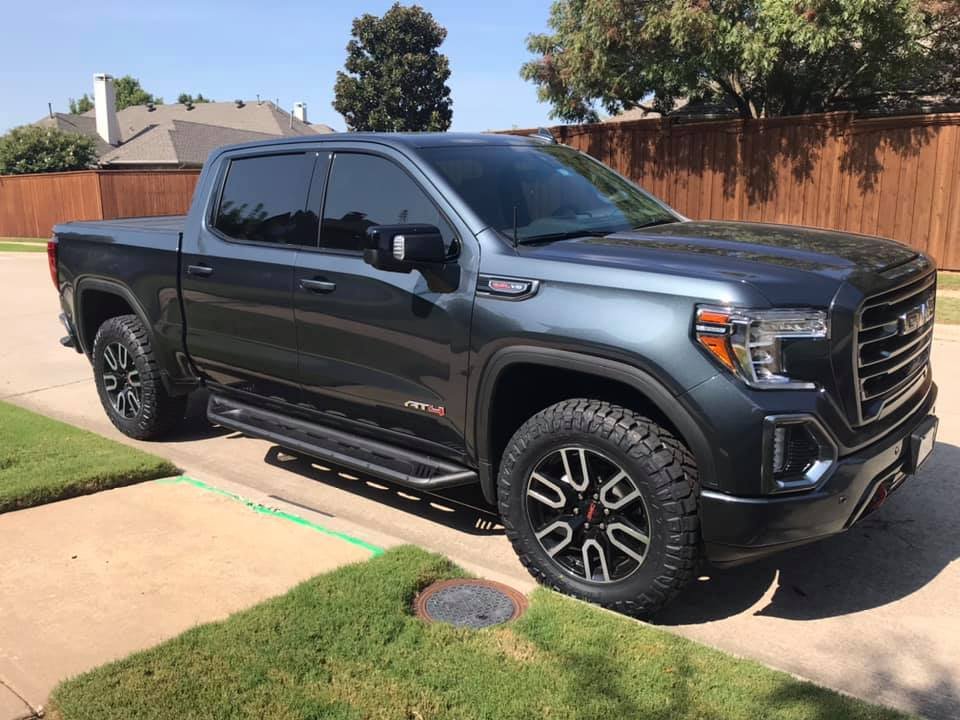

On 9/15/2020 at 3:51 PM, MTindall said:
285/65/r20 NRGs
Stock wheels
No lift
119510270_10103094312465422_3186227812565143886_n.thumb.jpg.6b49c56a0bbba46dbac8788fea484910.jpg119601610_10103094326826642_2574998786700707022_n.thumb.jpg.d805cc000496c2e6926150f4a2ba2e06.jpg
so this is a stock AT4 1500 and you fit 285/65/20’s?  Any rub or trim?
