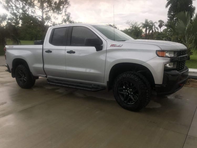

Thank you. What did you torque them down to? Any pics of your truck after install?
110lb/ft then 100 miles later 120lb/ft. Just a gut feel on that!
2 hours ago, Sin City Trail Boss said:
Thanks. So you were able to still use the stock u bolts?
Yep, there were plenty of threads and they were not stretched,
