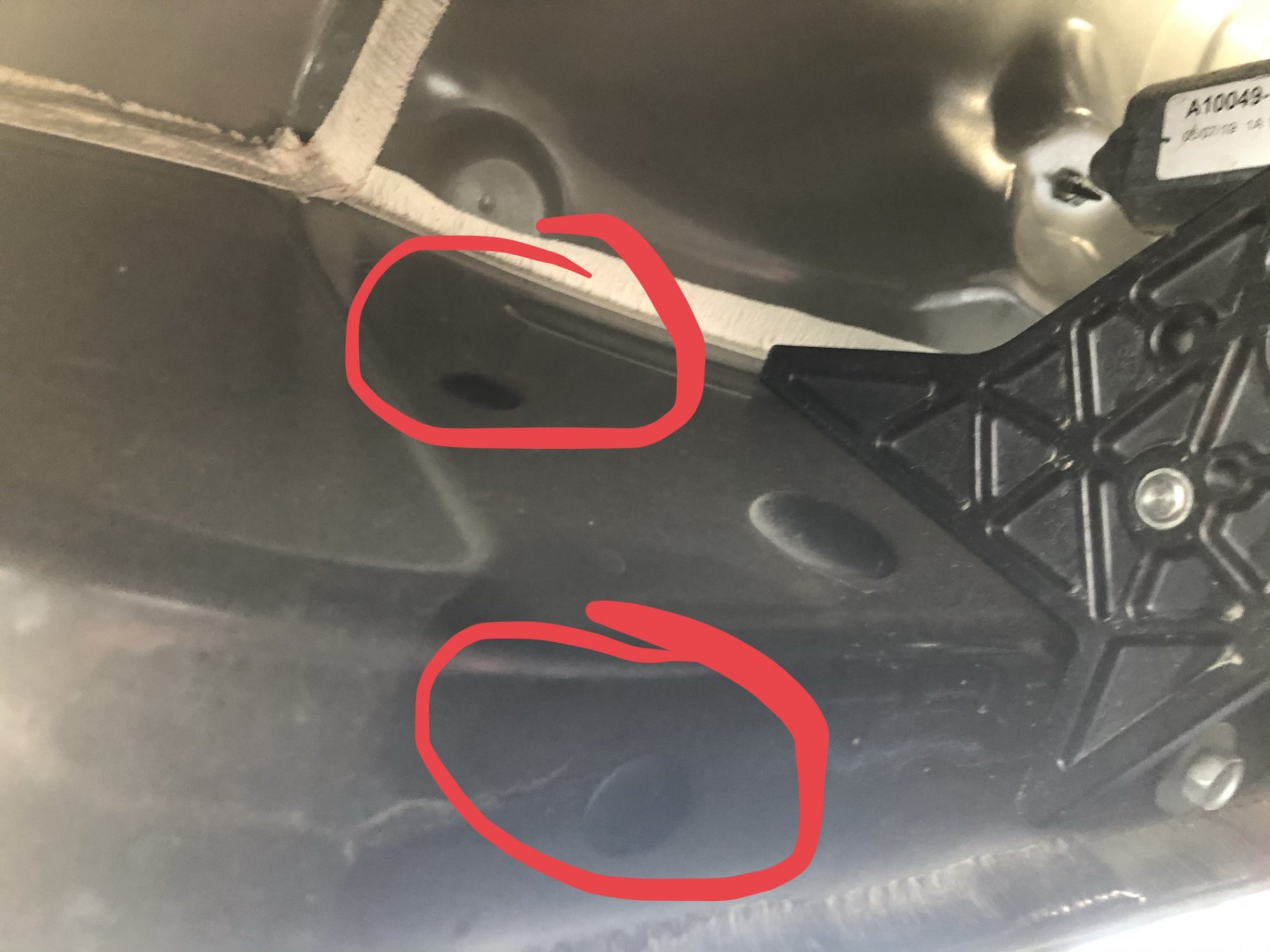

On the 2019? My dealer called yesterday and said my amp power steps are rubbing the frame bracket slightly when retracted.
Since I bought my steps at another shop I am going back there so they can look. Maybe grind off the tip of that bracket? It is strange?
Your brackets are in the wrong set of holes. They need to be moved forward into the next set. The instructions clearly state “second to last set of holes.” There is miles of clearance from that part of the frame in the correct set of holes.
The circled holes are the ones you are using now, which is wrong.
Yes, on the 2019s. Move the step bracket first but if it persists, take it back.
And the steps will close and clear that bracket well?
Yup, they are closed in the picture. With the bracket moved forward it is not even close to the part of the frame your steps are hitting.
