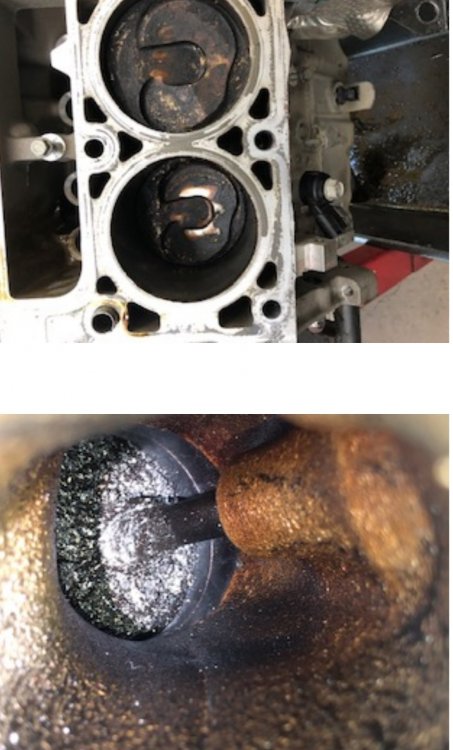

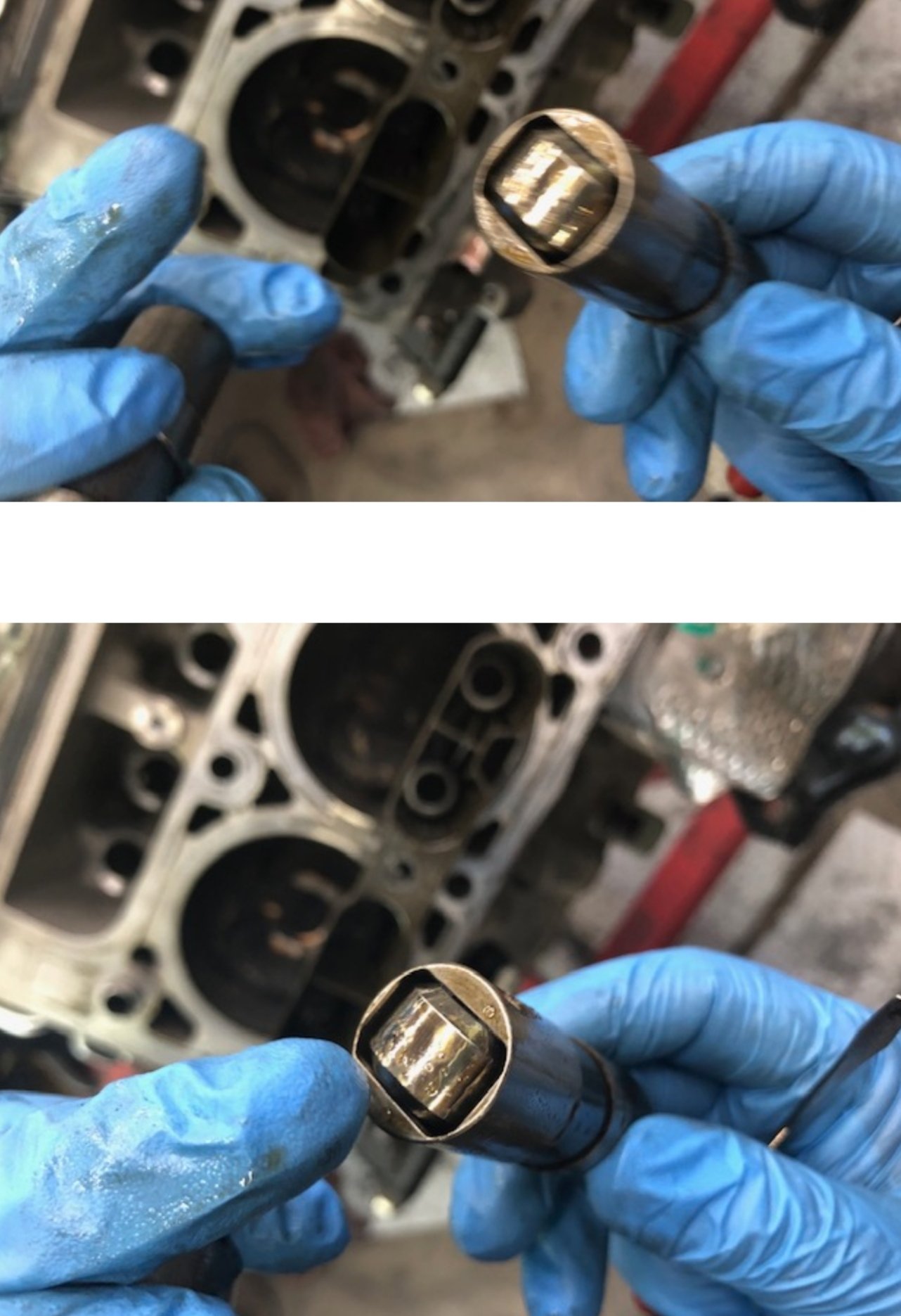

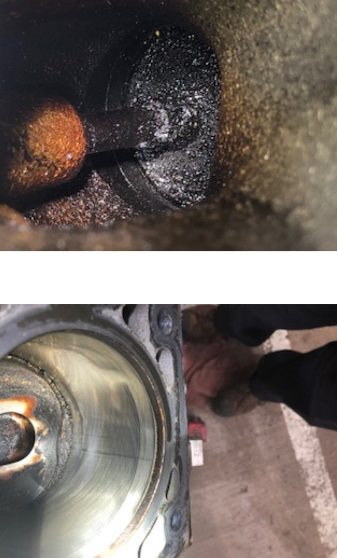

Can anyone give me insight as to what's causing my engine to be replaced at such low mileage? Went to get warranty work done because truck would have a slight knocking sound close to rear of front tire (bellhousing area). A week before truck gets dropped off, CEL comes on. It threw a P0308 code. Two weeks later, truck is still being diagnosed. Then, they report back saying cylinder 8 test was all good, but it is still misfiring. Noise persists and they reccomend engine tear down. They find that lifters need to be replaced along with camshaft due to pitting. Then send in parts sheet which include all new lifters, seals, camshaft, actuator and gaskets. Most of which are backordered.  1 month goes by and engine now needs to be replaced, a lot of carbon deposit and buildup is found and #8 cylinder wall is scored up. Deposit was so bad they say there was also rust.
My question is how did this happen? This truck is babied, never has seen WOT or even 80+ mph. Maintenance has been on time. Amsoil signature every 4-5k miles, premium gas (one brand all its life), synthetic air filter, a can of BG44K every oil change. I'm just confused? Is it bad gas? Is it improper maintenance? Someone help me out.

Good old fashioned AFM lifter failure. Not your fault, it's the design.
There are ways to extend future life of your engine after rebuild.
1. Catch can
2. Tune to remove V4
3. Forget 1 and 2 if you do a hardware delete of the AFM lifters and have them use a Texas Speed kit. You will need to tune out V4 or run a Range Module full time.

I’d like to see the rest of the valves as that one looks horrible for only 30k miles.

Spalling.
That is what you are looking at.  It has one or both of the following two causes.
1.) Poor heat treat.
2.) Lubrication break down.
GM is on the hook for the first. It's a QC issue not a design issue. The second can be a shared responsibility that goes to heat management and less frequently dilution.
Nice Pictures!  Yup, we be a coking!  Keep em clean boys careful with the GDI Eugene!
Interesting that it was a non AFM cylinder that failed.  Lifter might have spun in the bore/guide and bent a rod.
In other words... frequent oil changes are your friend.  Especially with DI engines.
They all look like that, really weird. The tech said the engine is way too young to look like that. Was thinking of a catch can when it was new, now I kinda regret I didnt. I wanna see everyone else's engine looks like
