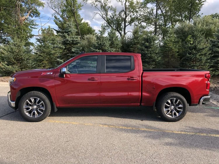

On 8/8/2019 at 3:14 AM, Michael Gardner said:
All, I really need your help. I am reading your experiences and I can relate where some people are not halo with the new 2019 Silverado ride quality. I am miserable in my 2019 Silverado LT. It is very bouncy. I was thinking to upgrade to the Trailboss or LTZ for a better suspension and ride quality and now I don’t know. I have taken my truck to the dealership twice and they say nothing is wrong with it. Can anyone tell me if the suspension is better in the higher trim levels than then LT?
It’s a truck not a car. Depending on the road it may or not be bouncy. The trail boss is going to be firmer. I don’t believe the LTZ has any different of a suspension. Different wheel size and tires yes.
I came from a 2017 Colorado and that’s the one thing I hated it was bouncy some bumps would even cause the rear end to hop. My 2019 Silverado double cab LT to me is very smooth and not bouncy at all. But that’s my opinion of it also the longer wheel base feels like the ass end doesn’t wanna come around on you because there’s a little water on the road.
