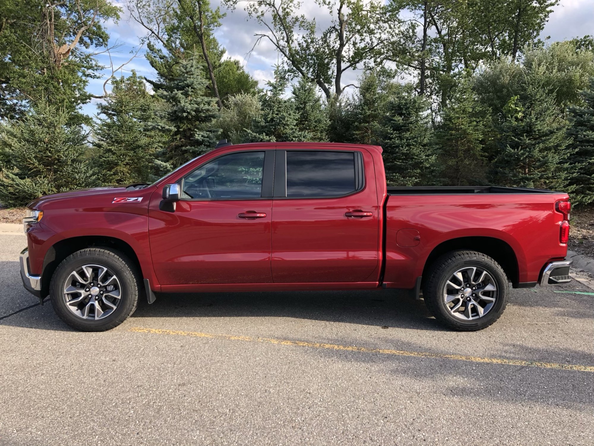

I have a ‘19 LT Z71 with about 2500 miles. I thought it was a little bouncy too but not excessively. I kind of liked the soft ride except when taking turns at higher speeds.
The truck came with 18” wheels and the Goodyear Wrangler Fortitude “off road” tires (still upset that GM marketed these all-season tires as off-road). I felt the sidewalls on these tires were pretty soft, contributing to the bounce.
Since I wanted 20” RST wheels, I figured I’d change the tire brand too. Went with Continental TerrainContact 275/60/20 and the truck rides firmer without the bounce. The handling on corners is much improved as well probably due to the stiffer sidewalls. Only slightly harsher ride on rough roads, almost not enough to notice a difference.

Would you care to share a pic?
I have an LT Z71 too.
I'm happy with the tires, just wandering what she would look like with 20's
Thank you
Thank you
I’ll take some today and post later. Have to wash the truck this afternoon anyway.
I really like like the way the wheel/tire combo looks on my truck. Huge improvement IMHO.
