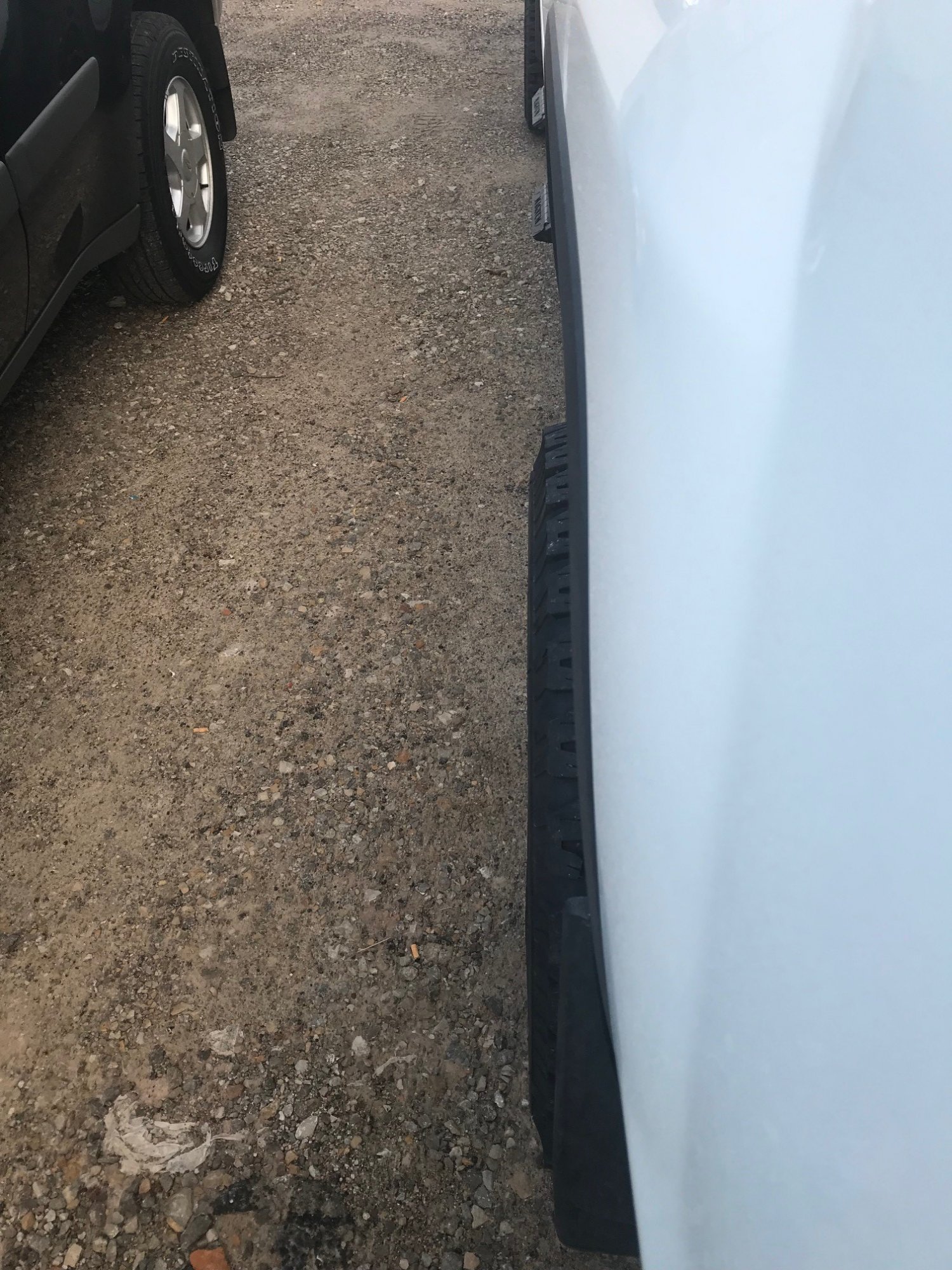

I just have Gator back flaps and am running 33x12.5's which are wider than yours. They do not stick out past the stock GMC flare with the stock GMC Snowflake wheel +25mm offset. You must have a negative offset, or a less aggressive positive offset. Some people love the looks of the tire sticking way out to the side, but then you run into the issue you are having. With GM paint being 1/64th of 1mm thick these days, anything will damage it if contact is often. Flares usually look kind of dumb, the low profile ones can look nice, but the ones with the fake bolt heads are hideous but they do hide the tires sticking 3"+ out of the wheel well. Mudflaps wont really help you as rocks will get stuck in the outer lugs and toss up on the body. Flares or more positive offset are your answer. Any pics of your set up? Here is what my 12.5's look like on stock rims, they do rub considerably FYI.

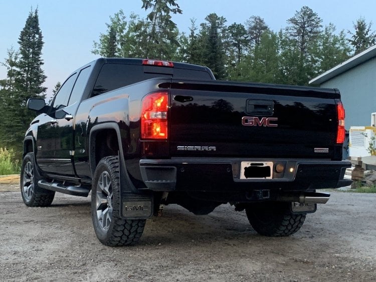

Here are a couple pics, they aren't the greatest pics, but I also hate the look of tires sticking way out.  mine do stick out a little as you can see in the pics.
Your tires don't stick out that bad, I have a -44 offset so my wheels stick out a bit but I think I will be going with flares with the fake bolts
