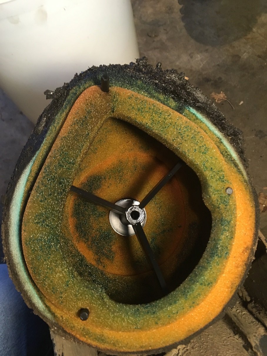

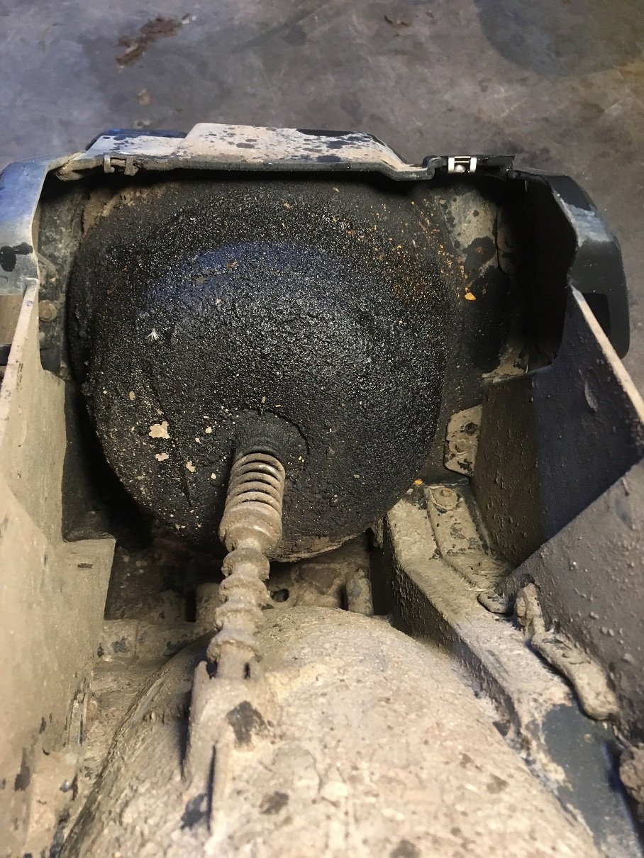

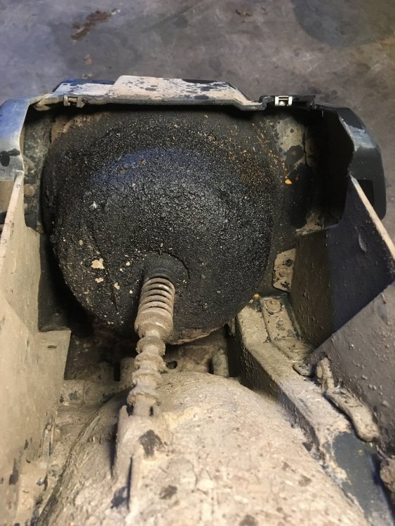

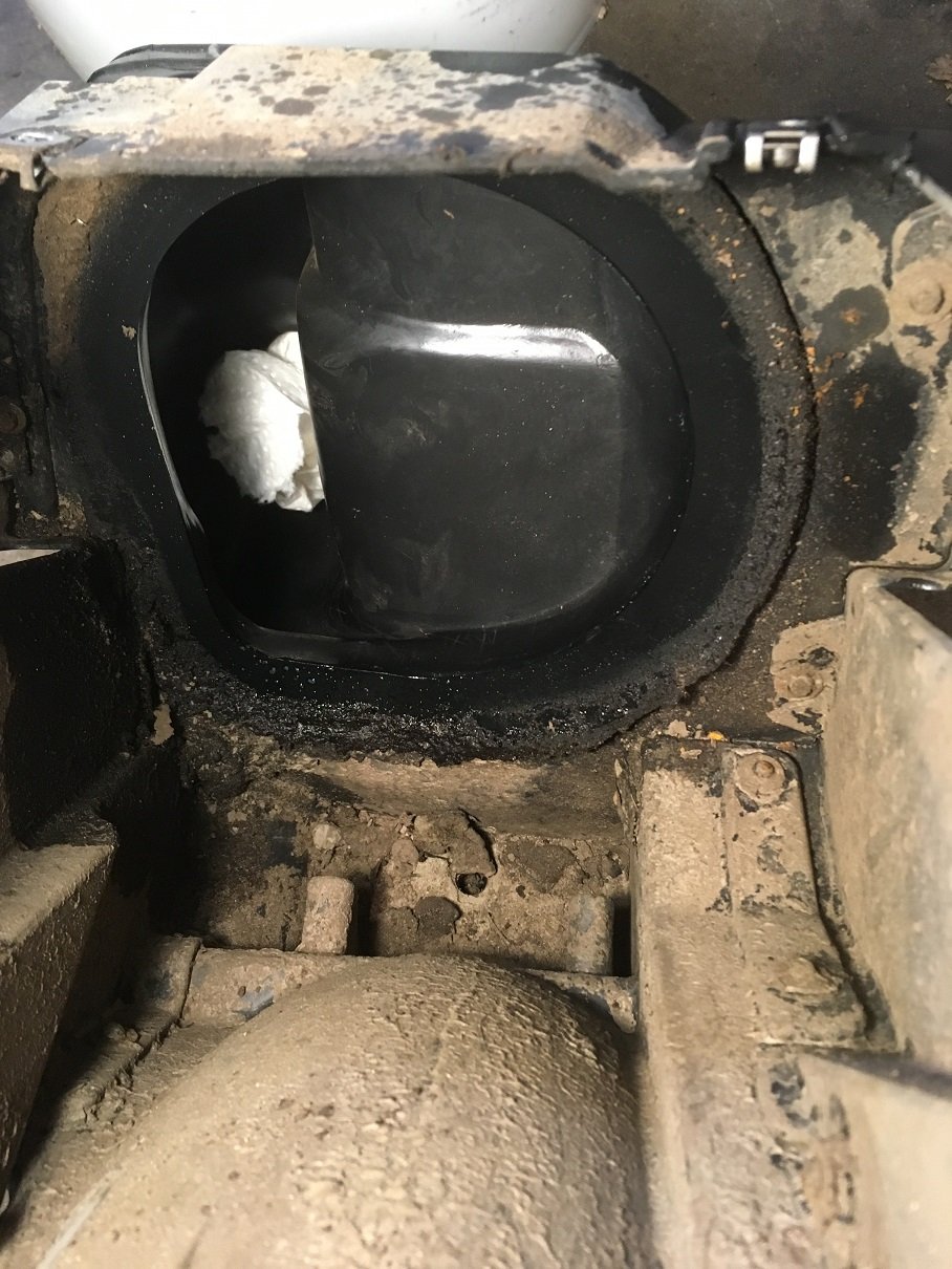

Here are some pics from the last AF change out:
Extremely dirty filter and airbox 250cc 2 stroke dirtbike (yes, there's an airfilter in there LOL):
Clean air filter backside and intake tract (tiny specs of dirt in intake tract are from when I removed the filter).
See how dirty the airbox and filter are? The filter looks horrible, yet still flowed more than
enough air to allow the engine to easily come on the pipe at will, with no loss of performance..
Most important is that the AF is doing its job well & everything, including the sealing surface maintained its integrity.

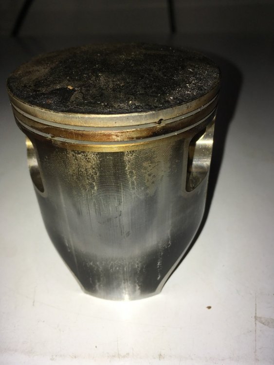

Does it work?
Yes. Here is the factory piston out of this same bike. It has 217 hrs on it. 250cc 2 stroke.
I could have easily left this in for another 200+ hours. Ring gaps still at factory spec. The
bike now has about 400 hrs on it. 2nd piston. Still at over 180 psi compression. Still on
original bottom end.
Most offroad guys I know with 250 2 strokes are rebuilding about every 80-120 hrs. They are also
changing their air filters all the time, because they have been told to.
