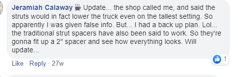

Someone verified they do bolt in, but with the Bilstein set at the max lift option it actually dropped the height instead of lifting it.
