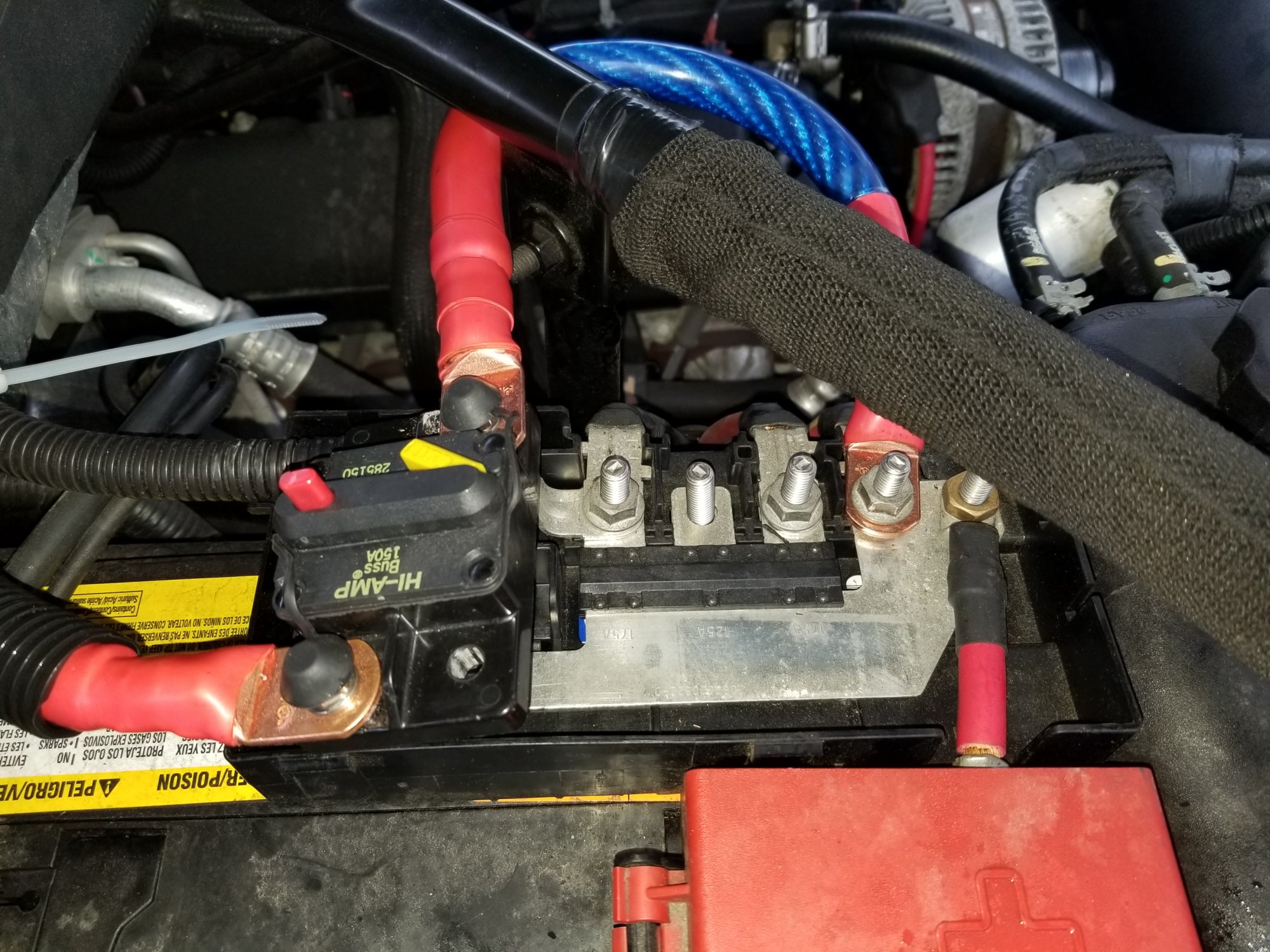

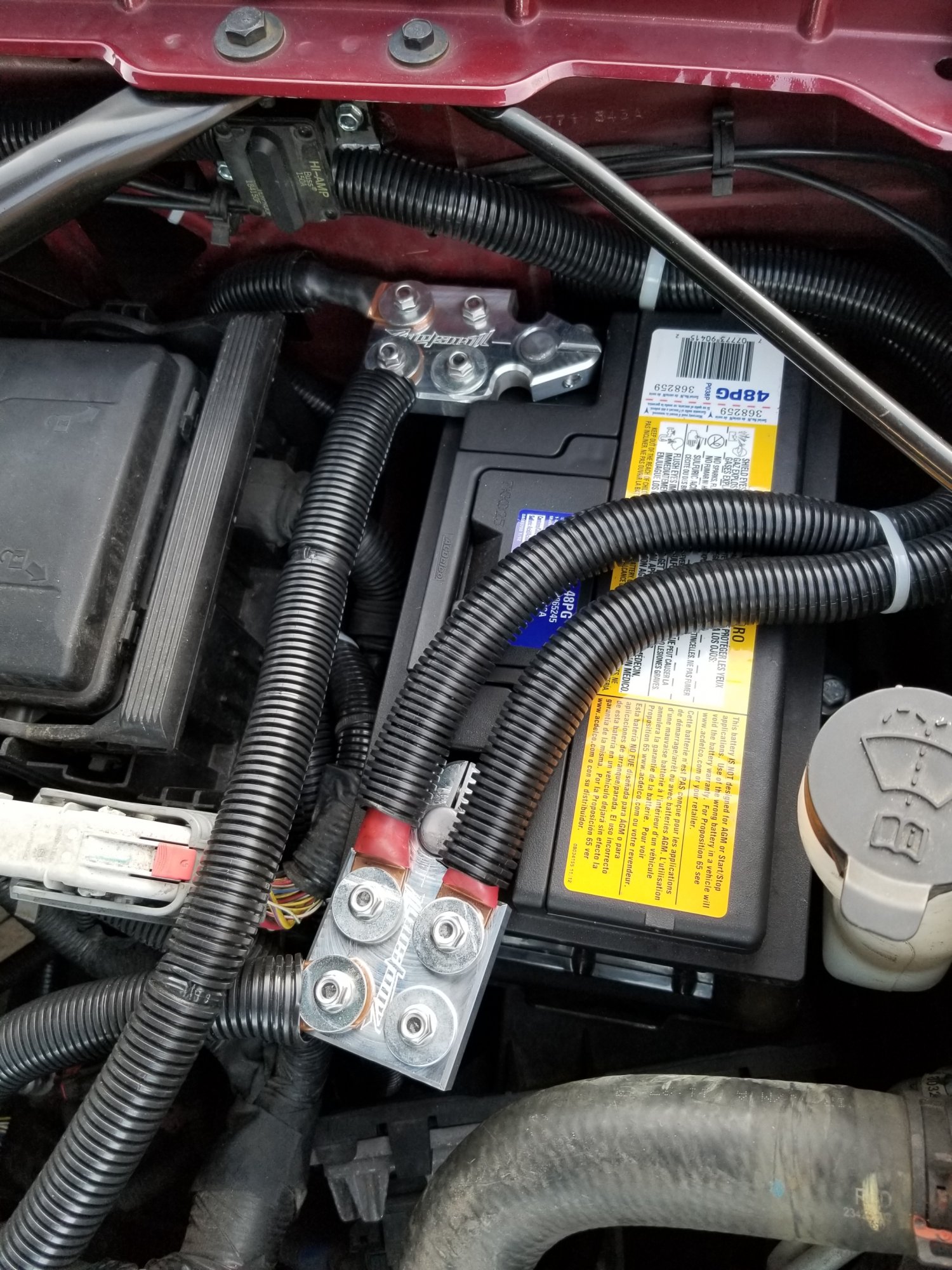

Since I don't want to buy yet another amp that I cannot sell I am going to run my old DC audio 5.0k amp at 4 ohms. The voltage from what my oscilloscope was showing was dropping to like 13.9 when it was trying to keep it up to 14v. My big concern is how hot the stock alternator gets and I don't even have the amp connected yet. I figured an upgraded one might help give me more headroom. That sensor on the ground cable I was thinking is to sense how many amps of current are being passed through. I shoved a 4ga cable through that hall effect sensor to send the power to the second battery under the hood. I would really love to run 1/0 power and ground to the second battery but there isn't enough room to squeeze that in the sensor with the factory ground wire.

Dont bother with the running the wire through the sensor. It still works perfect. I run a power wire from stock to second battery. Another from alt to second battery.  Ground wire from second batt to engine. Another from second batt to chassis. Then power and ground from second batt to stereo system. Of course I used a few breakers to completely isolate everything quickly if necessary. All cables are 2/ welding cable except the little jumper on the top of the stock battery.
