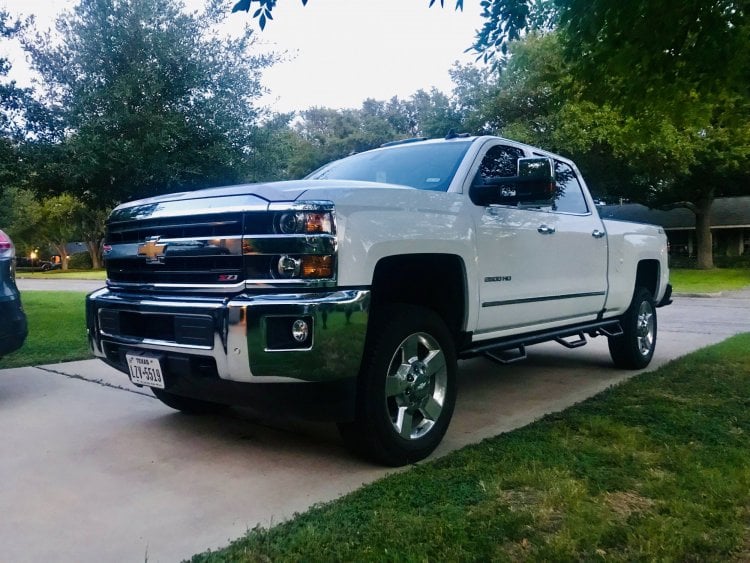

I have an ‘18 2500 with the 6.0 and I’m wondering what’s the best option for getting a few more ponies out of the motor. I do enjoy the performance of the truck so far, but more isn’t a bad thing. My only hold up would be that I don’t want a super loud exhaust. Short story is that I’m wondering if anyone has had good results from an intake/exhaust upgrade?
