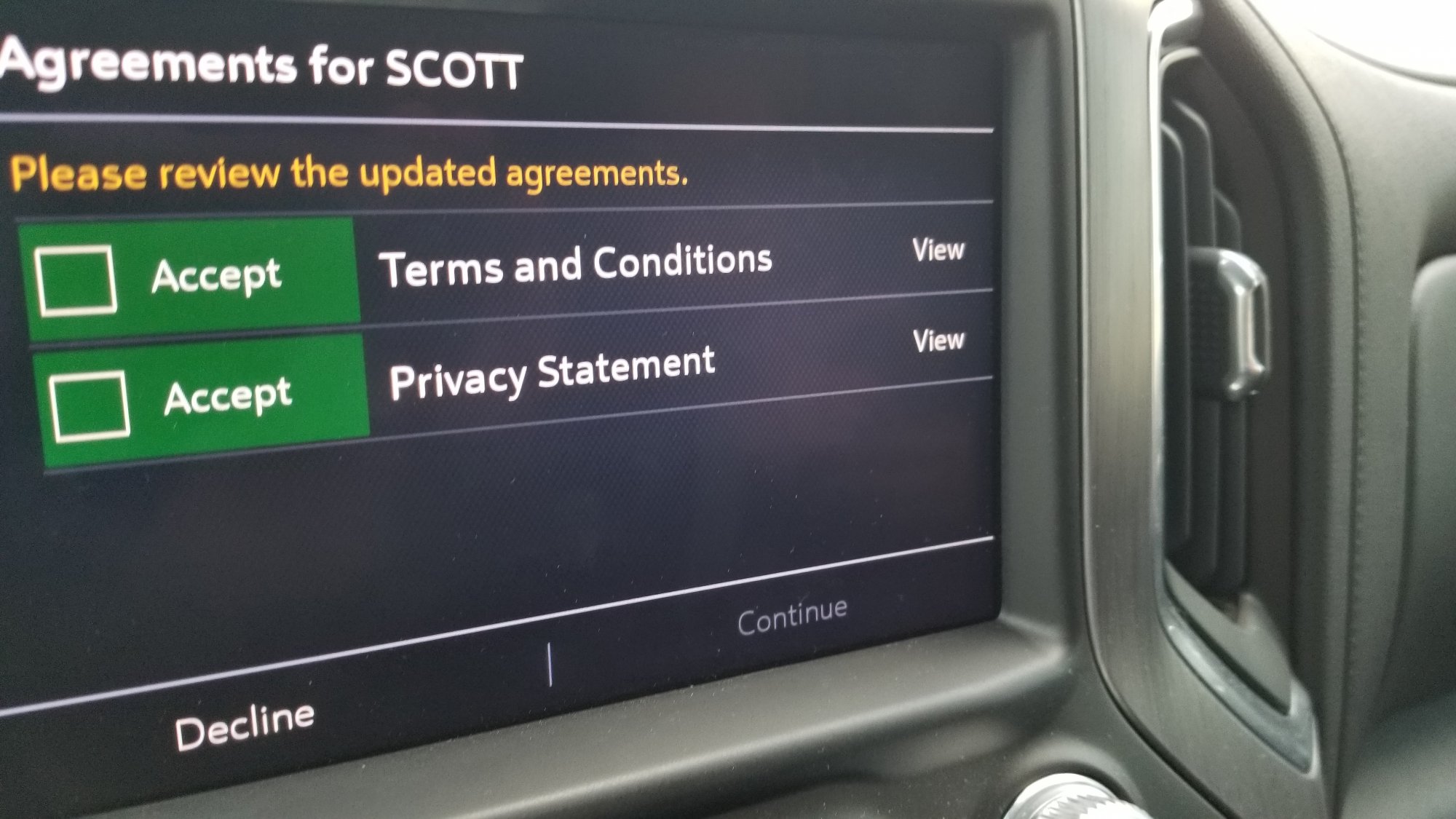

Anyone else get repeated notifications to acknowledge agreements? Doesnt happen everytime i start the truck but often enough to be annoying.

I only got the acknowledge agreements screen the 1st time I set up my profile on my 2019 Silverado 1500.  I have gotten 3 software updates since and no additional acknowledgment was required.

Its intermittent, not every day/key cycle. Id guess every other day/4- 5 key cycles

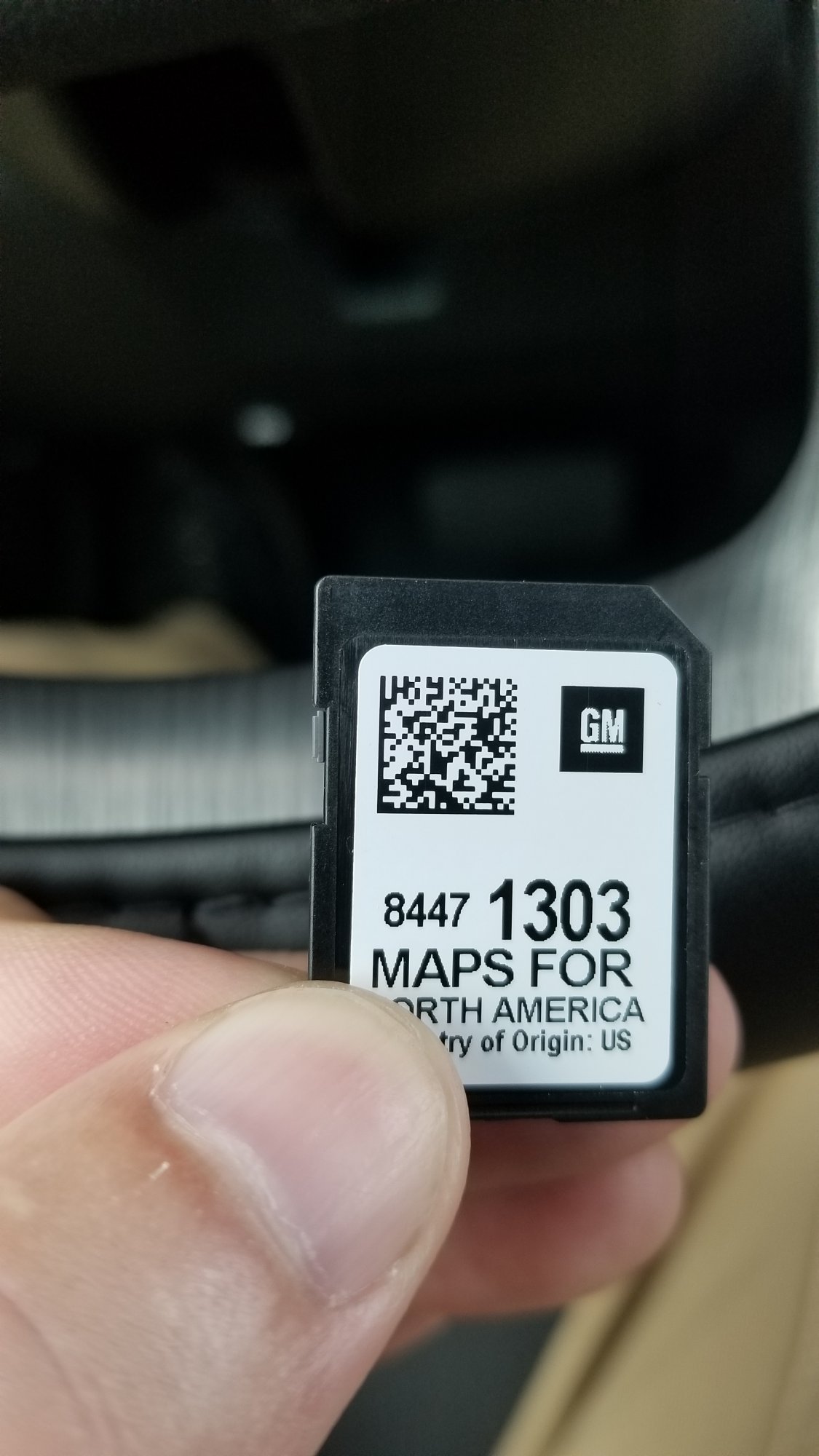

I would recommend trying to see if your SD card is unlocked.  Power off vehicle, open and close drivers door, and let truck go to sleep (wait until green monster light is out).  Open center console, remove SD, look at SD card and there is a gray slider on left side of SD card, make sure that is in up position.  Reinstall SD and start the vehicle, accept all the messages and see if any return after a few key cycles.

Mind of it's own, sometimes it's 5 or 6 starts in a row, sometimes it's good for 3 or 4.
All the freaking time!  It seems to only happen when at home, and I do have it connected to my home WiFi. Wondering if it’s updates or what not but geez it’s annoying. I was coming here to post about it as well.
That makes total sense now that I think about it.  It only happens when I am close enough to my house to be connected to it's Wi-Fi

Try blocking access on your router to see if it is indeed caused by hooking onto the Wi-Fi.

I beleive this is the correct position.
