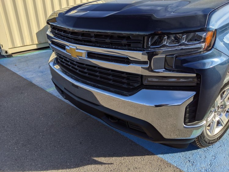

I noticed since mine was the smoke color it was trapping water inside and a boat load of pine needles that somehow got in there. Then I noticed the 3m tape was coming off in the corner and starting to lift off. Not from the truck but from tape to bug shield. So I removed it before it flew off on the freeway. It was a painful exercise to get that 3m tape off. Won't ever put one of those on again...
Don't attempt to remove it without a hairdryer or heat gun to loosen the 3m tape adhesive. I don't know how I got it off without damaging paint. I was filling expecting it to rip the paint coming off. It was stuck on there good.1dd740ff446551ace56137d2459d4d47.jpg

Best way to remove it is with a fishing line. ‘Floss’ it up away from the truck and it’ll come right off. Clean up the remaining residue with a little alcohol or some other cleaner and you’re good to go. But the one I have has little channels for the water and debris to escape to.

Well that just sucks.  I don't think I've ever seen one come off the deflector first.  Hopefully they will replace it for you.  I use 20lb test fishing line and a heat gun and comes right off.  Hard to do on the side of the road I'll bet.
Thanks for the fishing line tip. I only paid $40 for it. I tossed it in the trash. It isn't worth enough to bother with a warranty replacement. If I did do it again it would be the matte one. The smoke one was very scratched up after 3 months.
Paint protection film on the front might be the better way to go in my opinion.

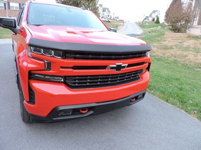

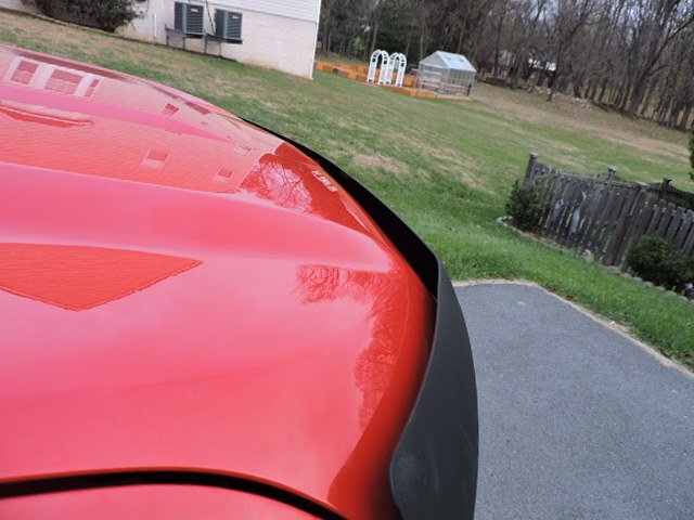

.02    M<y prediction aeroskin may soon become swearoskin!  Been there, done that with a sports bra; and nothing is touching my hood except rain water air and wax!
Exactly what do you think will happen after accumulations of road salt, alkali soap, pollen dust crap finds its way through gaps in the tape and accumulates under there for months or years? Like the hood hugging bra, trapped moisture combined wit the heat of the engine under the hot Summer Sun boils the trapped moisture and the hood underneath gets the crap cooked out of it which sits on the surface of your Jello hard clear coat. As many leaving their bra on too long soon discover the clear coat turns milky or delaminates. So unless that "skin" is hermetically sealed so not even a dust particle or drop of water can trapped underneath you're setting yourself up for a potential screwing.
Once burned, twice wary.....I took the hard way out and installed an off the hood EGR deflector. And what a pain in the ass to install because in order to secure using the existing underhood pre-punched holes they are forced to use shallow fasteners, impossible to install without a third hand and a small step ladder. Chevy website wants $109 and Amazon $52 probably because of a 1.5 star rating.....not for the quality of the product, but the crapo directions and frustration of the install. But for those willing to take the time and effort this provides a real class look, the black matte finish option providing a match to RST and similar bumper trims and not just a shiny piece of plastic glued top the hood. A nice solid mount with space for cleaning and waxing the hood underneath and can be removed in less than 5 minutes with noDSCN0716.JPG.15d228f3cd27650be2017d33d82a1d2f.JPGDSCN0717.JPG.e2ff219eaf4f447f7f9f4520251dd0bc.JPGDSCN0718.JPG.68efb4e02e6807b27e45d3f677140d73.JPGDSCN0719.JPG.0fc736c267e6105212cf889252e59701.JPGDSCN0720.JPG.15bf01b86a33f24a2885c54f99ae04f8.JPG remaining trace of install and the hood completely intact.
