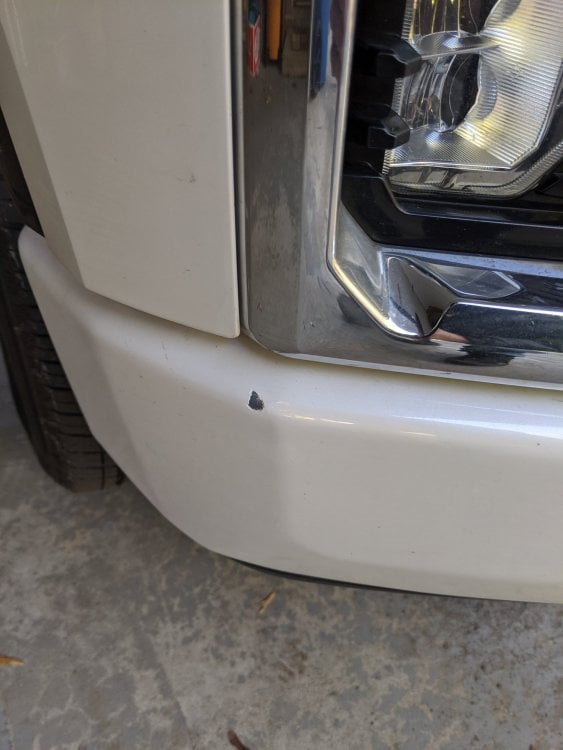

Is the white frost tricoat as miserable to match as the old white diamond?  Or am I best having the bumper repainted?  I received a nice chip last night on these beautiful Michigan roads.

Try Automotivetouchup.com.  They're here in Louisiana. I've always had a perfect metallic paint match using their paints through the years. Not sure about the match on the White Frost but they have it. It's the same code but they list their paints under different names. You may need primer touch up with it. Once touched up with the base coat, build the clear up then wet sand until flat with existing clear and buff. If you're not comfortable doing it, a good shop can. The site has how to videos and instructions. YouTube also has good chip touch up videos. Good luck.

Wouldn't use a pen. Too big of a chip for a pen and won't make a nice job. I use the paint and get good brushes from a hobby/craft store or Hobby Lobby in different sizes and very fine and pointed. Sometimes the brush in bottle paint is too large for tiny chips or scratches.

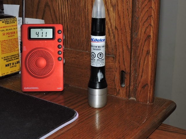

Got it, have it, tried it and used by itself works like crap!  Nothing more than iridescent colored snot, might work with a buildup to 20 coats, but cannot get good coverage of the primer coat used by itself.
A very close to perfect match can be had by first using a base coat of GM Summit White or Duplicolor Universal White and then two or three coats of that pearly transparent snot they call WA-140X.
Photo shows two heavy coats without white base shown over black plastic of the bottle.
