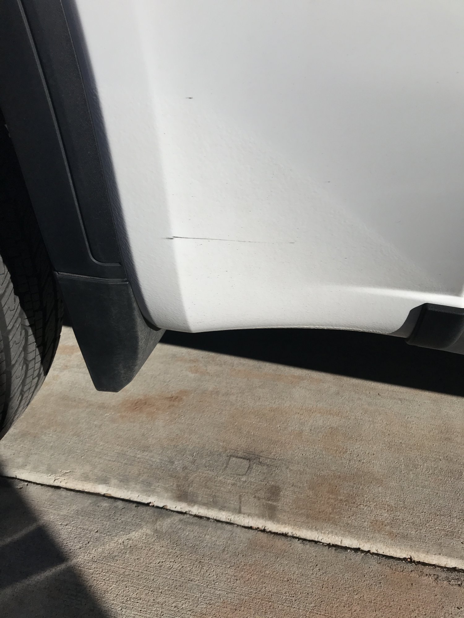

So long story short I just got a brand new 2019 Sierra 1500 about a month ago and just the other day I noticed a scratch in what I call the textured paint area by the rear wheel. So I tired scratch removers, tooth paste and pretty much every idea I came across on the internet.
My question is what else can I try? My last resort is that paint pen they sell in the service area but I feel like it would look weird with the textured paint
thanks for your help! Picture for showing the scratch
EDIT: I have not dried using a polisher because I don’t have the tools for it. I only tried stuff that’s cheap and stuff around the household

That looks like it might be through the paint layer and into the primer....so I agree with a Dr. Colorchip or other touch-up paint kit.
I had scratched my Enclave in almost the same spot one time and touched it up.  I didn't do a great job up close, but since the scratch is really out of your line-of-sight, I don't think you would notice it if you did even a mediocre job of touch-up.

Unfortunately my bed isn’t out of aligned because I would of definitely try that method lol. But that’s good that your getting it taken care of.
Yea I was super upset when I saw the scratch but I’m praying the dr color chip will work. I ordered it earlier this week and I’ll update the post with pictures once I use it
Dr. Colorchip might work, may need to make several applications IE let the paint dry and add more because that's a pretty deep scratch... A good body shop can fix it for you by repainting the bed side, will prob run you $500... Had to have my front fender repainted because I got too aggressive trying to buff out a scratch and burned through the clear coat..

Did you try a mister clean magic eraser?  if that doesn't work, 3M makes a clearcoat scratch remover pen that works quite well.  is similar to this.  https://www.carwerkz.com/products/fix-it-pro-clear-coat-scratch-repair-filler-and-sealer-car-paint-scratches
Magic eraser lol? It's not a scuff it's a "scratch" through the clear an possibly through the base and primer. Eraser won't put color back or fill.
1 hour ago, Bulkingallyear6 said:
Yea I tried a scrubbier before and nada lol. Unfortunately I can feel the scratch so the dr colorchip is my only hope. Still waiting on it to be delivered so I can try it
Looking forward to your review...
UPDATE!
I finally got in the dr colorchip and I did a test to see if it worked. It actually did pretty good the first time, but I do have to do another pass because one part is deeper then the rest. The instructions were very clear. I did mess up but that was my own fault, put to much paint on it. I will update in a day or two when I put a 2 second coat on it. First picture is the original and the second one is after the first coat
Are you sanding the site smooth between coats? Will help to keep the touch up paint in the scratch and not the surrounding area.
