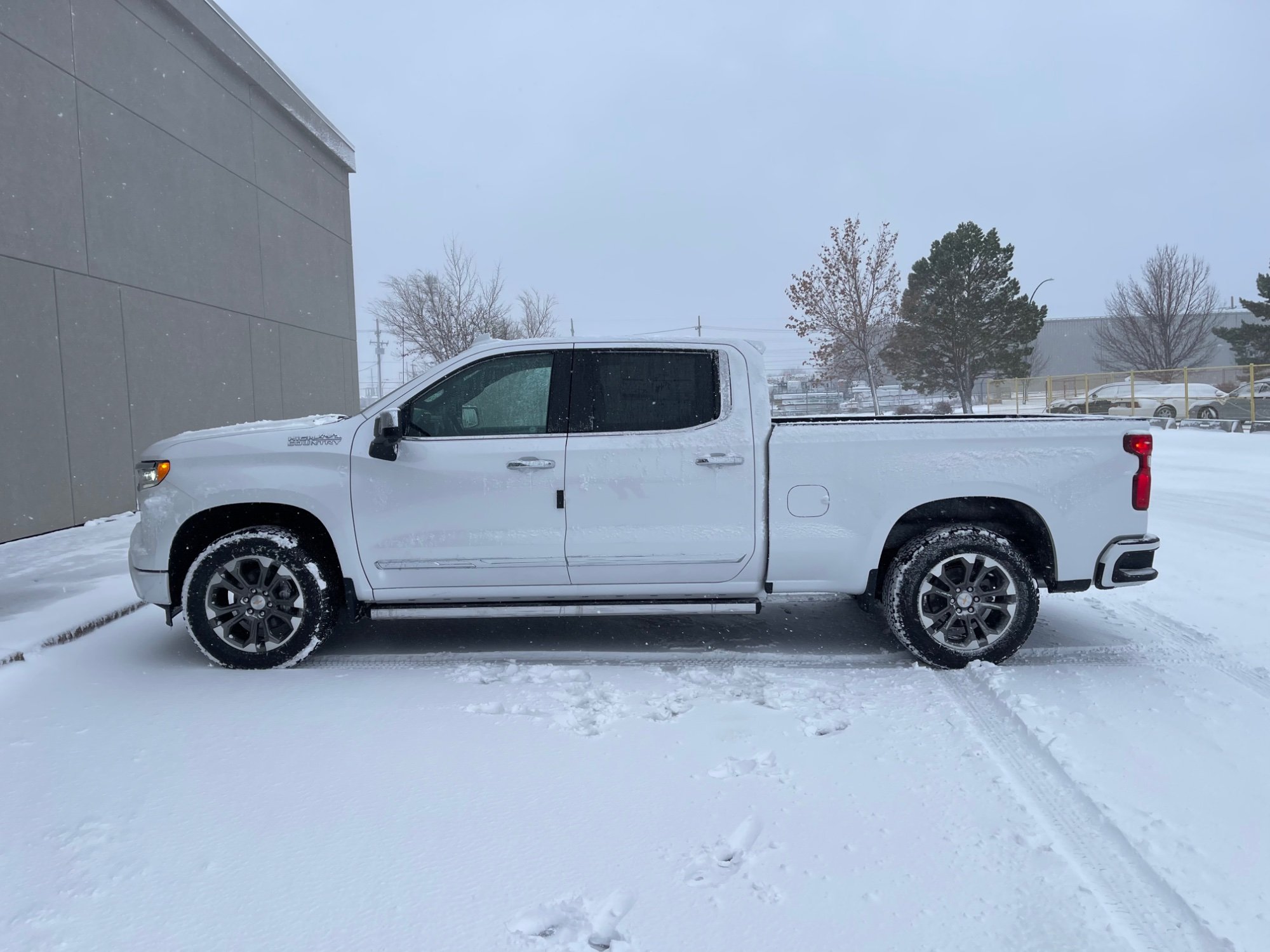

Hey man. Does your high country have the tech package with 360 cameras, blind spot, etc? My ordered high country just showed up at the dealer with everything I wanted except tow mirrors. Wondering if you got this swap to work because I don’t want to wait another 10 months for a new build if I can order these mirrors and do the swap without losing any functionality. My dealership is telling me they cannot do it.

If I could just order a new one and have it show up within a few months I’d do that but this one was ordered way back in January and is absolutely perfect aside from the mirrors. 6.2, max tow, tech package, multiflex tailgate, retractable steps, iridescent Pearl, nightshift blue interior. Very frustrating situation… doesn’t make it easier that when he said it was on its way I went ahead and bought rims, tires and lift which are sitting waiting to be installed. Should have known to wait for the truck to show up.
