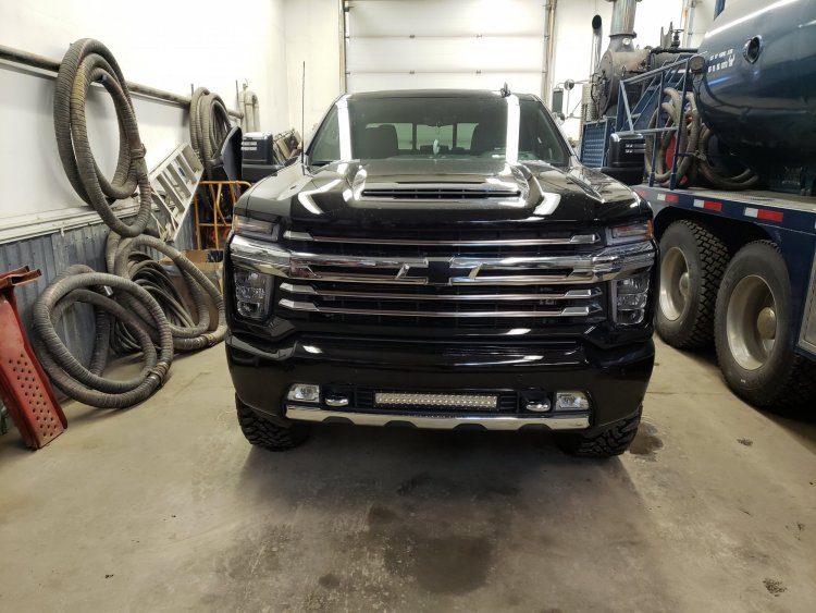

Thank you for all the replys , no there was no factory spare Auxiliary I will try to ordering new knee bolster  using those numbers u mentioned in February thanks as for the light bar mount it was a bit of cutting to get 20" in and I had to fab brackets because lack of room angle of feet .
it does sit in front of bottom luvers I would recommend a smaller bar.  Note: luvers must be working or causes a engine light found that out the hard way.  ( would not recommend blocking air if your a regular heavy hauler.)
Thanks again
