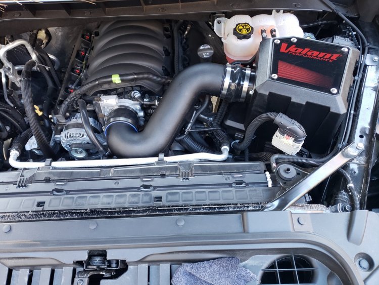

On 1/1/2020 at 5:56 PM, Billet Bowtie said:
I felt the same way. I ended up purchasing the Volant. With the MIT and filter costing over $200 and the Rotofab at $500 the Volant seemed to be the best of both worlds at $275. I really like the look of the Rotofab but for almost twice the price and most likely about the same performance it just seems over priced for a air intake. The above picture of the Volant is accurate. The top of the airbox is a couple of inches higher so the higher volume cone filter can fit. Here is a picture of mine installed.
Have you realized an increase in mpg, especially at highway speeds? Did you need to get a tuner adjustment or did the system adjust automatically? Thank you.
