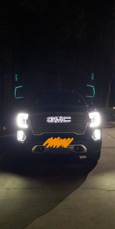

On ‎2‎/‎7‎/‎2020 at 7:04 PM, 3MTA3 said:
Here is a pic of mine before and after.
