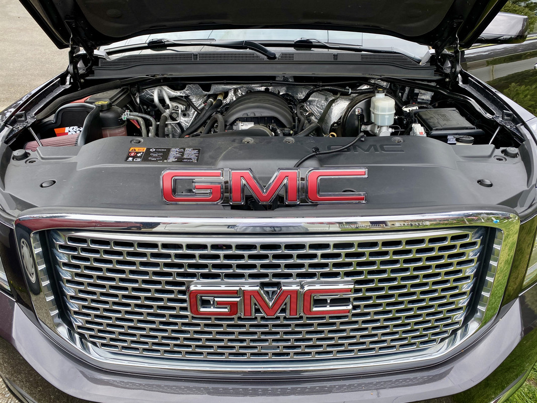

New info
I know this thread is for real truck owners, but I do like the new emblem. I ordered one for my 2016 Yukon XL Denali. The logo arrived last night and I feverishly hooked up the plug'n'play harness that accompanies it. Long story short, it was integrated to my turn signal. I re-spliced the jumpers off the signal and onto the feed for my marker lamps. Seems to work now, but I can not tell it is on in the daylight. Obviously it is more noticeable at night. Also the logo illuminates when I turn on my fog light. might have to try another wire that is hot when parking lights are on.
Question.
Is the brightness/intensity satisfactory for you?
I wish it was a little more intense. Maybe it is not meant for a 12V setup. I will figure out mounting later.
If this comes together, I will update with some better pics.
