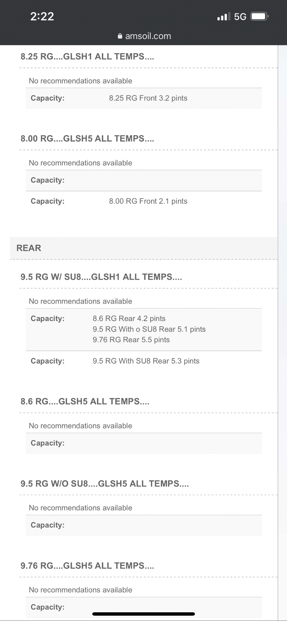

Do you know the capacity for the diff fluid on the 1500? I checked amsoil website but I don’t know which code I have
