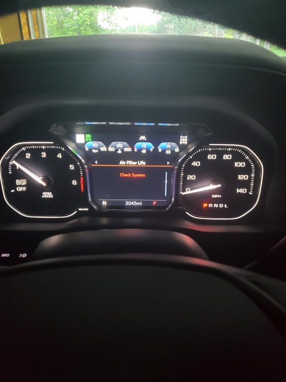

Maybe I spoke too soon about not having issues... Every time I start it now I get the "check engine air filter system" message. I don't get a CEL, just the message. I disconnected the battery again for about 4 hours and made sure the air filter life is unchecked in the information page. Not sure what I did wrong, but its pretty annoying...

I reached out to S&B to see what they recommend I do. I will update the group with their response.
If you go to S&B's website and locate the intake for your truck, there will be a link to an install video. At the end of the video they show how to navigate your driver info menu to disable the air filter monitoring system. After I did that I haven't gotten any error messages regarding my intake.

I did that initially, and I just repeated the process last night. I disconnected the battery for 3+ hours, but when I went to the air filter monitoring system, I now do not have an option to disable it... It only shows up red and says "check system".
Oh man that's strange. I'm not sure what's going on there. Hopefully S&B can answer that for you.
Update, this was my fault... Got the air filter monitor reset and disabled, correctly this time. No more lights!
