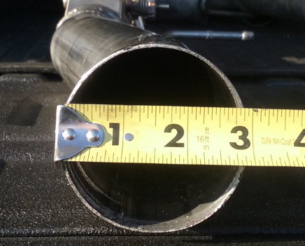

Gap at front connection to cat.
New Borla Exhaust = 3 Inch
Stock Exhaust = 3.5 inch
Looks like this may be for a 2019+ 5.3L as they come with 3" pipes before the muffler.

Thought I'd share an update. Fast forward 7 months and finally did get my money back for the first exhaust. (Long story there..)  Then re-ordered but this time directly through local GMC dealer.  When it arrived low and behold it was the exact same as the first one.  This time I was having the dealer do the installation incase there were any fitment issues and I asked them to double check the fitment and they were able to bolt it up fine.
So what I really don't understand is how can stock pipe be 3.5 and this only be 3 inch (pictures above) and have any better performance or exhaust flow?  The flange up near the cat also is smaller and doesn't fit quite the same, and the front hanger is tilted more sideways now but it is on.  This makes me think it's really made for the 5.3... BUT I now also have two different systems ordered at different times from different places that were both identical. Which is giving me mixed signals on weather it's actually right or not?
I can't find any specifics on what pipe size it's supposed to be but when I look on Borla's site directly their systems for the 6.2 clearly say 3.5 inch.  Anyone know the specs on what the pipe size should be for PN# 19303345 from the cat up to the muffler?
End result is it's on, dealer installed, looks amazing and sounds equally as good, so as long as it's not increasing backpressure or decreasing performance should be fine, but is really bugging me not knowing weather it's right or not.

I can't speak to the GM performance exhaust but I just put a Borla Touring with dual rear exit on my truck.  The pipe was 3.5" on my Borla for the flange that mates with then end of the catalytic converter.  The 5.3 is suppose to only have the 3" flange, which I found out when trying to buy a new flange clamp since mine broken when trying to get it off.  I got the 3" clamp first not knowing there was a difference and then had to go back and get the correct 3.5" clamp for my truck.  So my guess is you were send the 5.3 version of the exhaust since it has the 3" flange.
