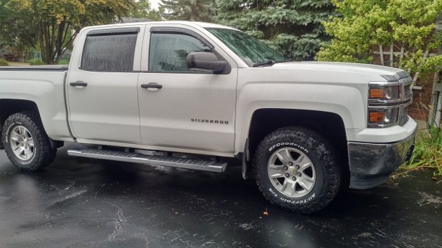

On 3/17/2020 at 7:15 AM, silveradosid said:
same tires as 2018GMC
Those are the exact tires im looking at, thanks! Edit: Actually I was looking at the KO2’s in 285/70R17 but since my truck is leveled I think im going to get it
285/70r17 work too. That's what's on my leveled 2014.
