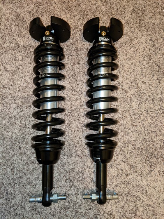

Is anyone running this kit? I’m about to pull the trigger and it seems you can’t find much information on ride quality or pictures of it installed. Please post pictures if you have any of this kit installed.
I just bought this kit, should show up on Friday.  Ill follow up with pictures after I install it.  Other people that have installed it should chime in but from what I've heard the ride should be better with a "more planted" feel.  I've heard it will lift the front of a non trail boss anywhere from 1.9" (or less) to 2.75-3"ish depending on what setting you put the front struts on.

Which setting are you planning on using? I’m thinking I want mine to be around 2.5-2.75”

I just had mine installed Monday and am thoroughly happy with the results. I went with the second groove for the strut and installed a 2” block in the rear. Rides great!! Will get a better picture later.

Very nice. Looks like the front is slightly higher even with a 2” block. Would you say it have you 2.5”

It looks high in the front just because of the angle - it actually has a slight amount of rake still for when I am pulling my trailer.... I got it from Eibach
What 2" block did you use? Can you measure the front now you have the Eibach's installed?
How much did the 2” block lift the rear. Do our trucks come with blocks from the factory? If so, does anyone know what size the stock blocks are?

Looks great! Second groove from the bottom(1.9 average lift)?? Also what size tires did you go with?

Thanks!! The springs give you 2" alone - the second groove is like .7" more. I am running with Nitto Ridge Grapplers 295/60/20

He’s on the second groove from the top, not the second groove from the bottom.
I also have mine set on that groove. It’s the sweet spot for this truck if you’re running a 2 inch block out back.

If I’m not adding a rear block, do you think second ring from the bottom will be the best option to be pretty level? I’m thinking about running 33x12.5x20 or 295/55/20....thanks for your help

How’s ride quality on that setting? The picture I posted above of the instructions was for installation of the lift springs onto their adjustable struts. Looks like the spring is good for 1.2” additional lift alone. Taking the difference of the two lift height settings, I would estimate the 2nd ring from the top to be around 2.6” lift. The instructions say ride quality will suffer at that high of a setting. How are your angles on the CV axles/UCAs?
