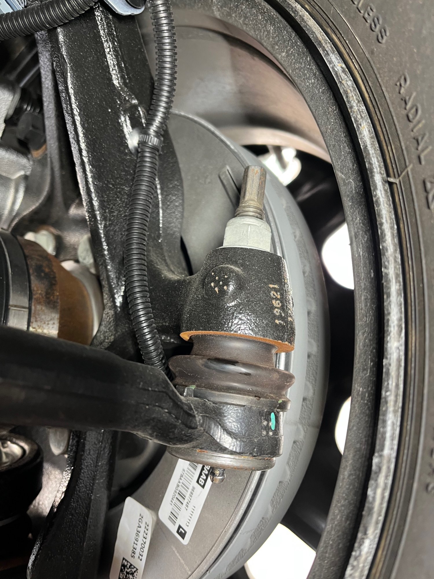

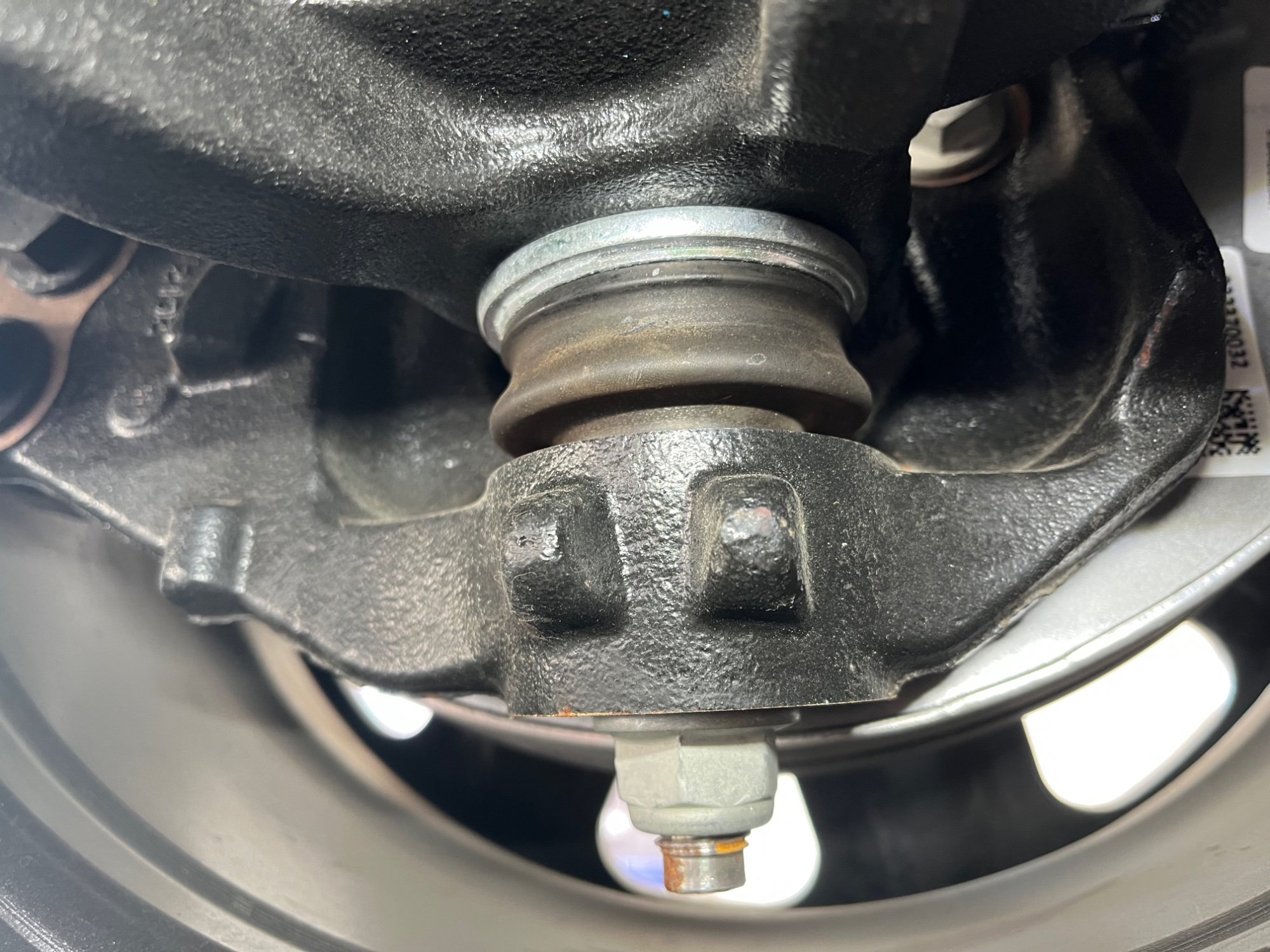

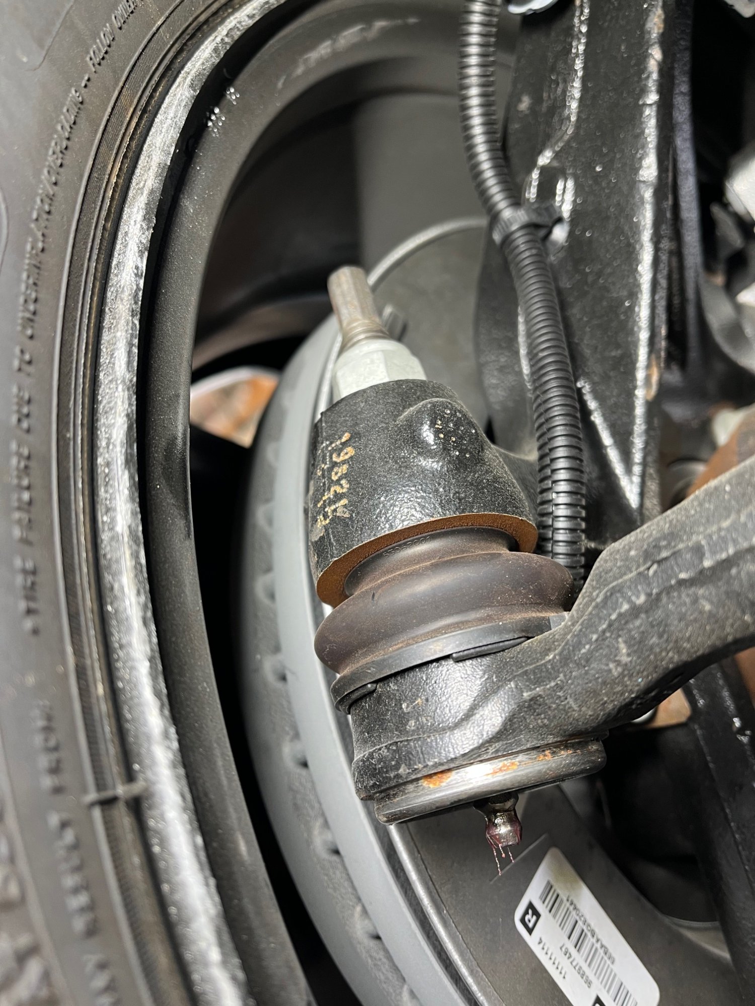

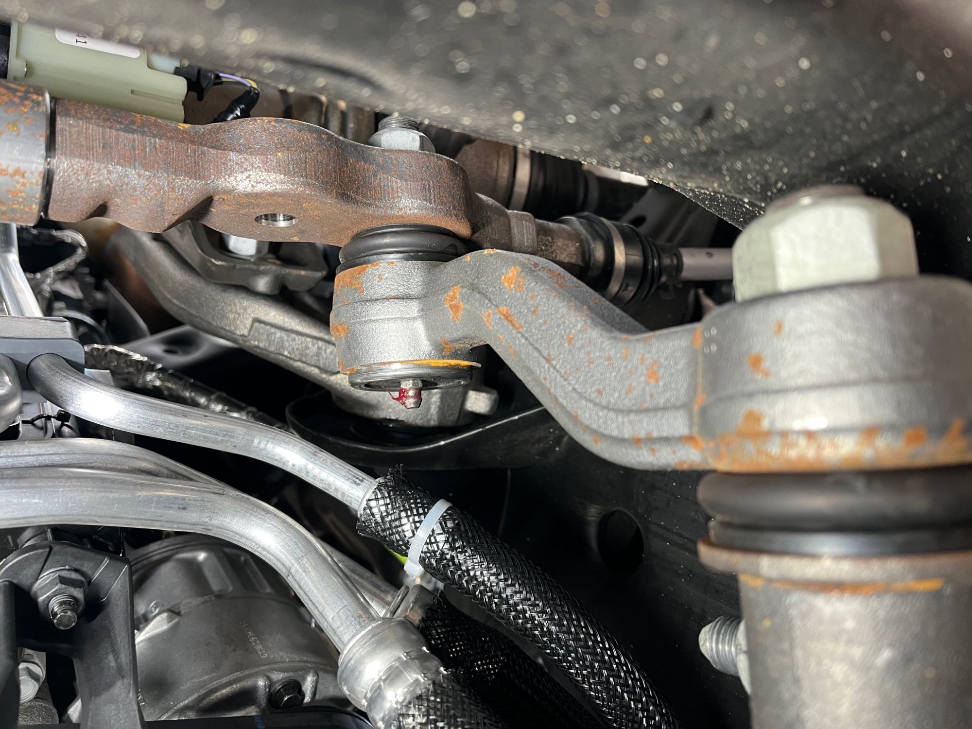

After reading this thread and others I decided to get under my truck yet again with under 200mi on it.
I found all 9 zerks and nearly all of them had what appeared to be no real grease. The boots were very deflated on almost all of them. On a brand new truck. I got some good pics to share so others can see.
mine took between 4 and 10 pumps depending on which it was. I didn’t just keep pumping away, I didn’t want to push any out as I wasn’t 100% sure they have the one way flaps, anyone know if they all do?
I put in enough to make the boot appear full but not ready to burst.
I pretty easily got to all 9 with an 18” flexible hose on my pistol grip gun.
here are some pics
Edited by Pryme
