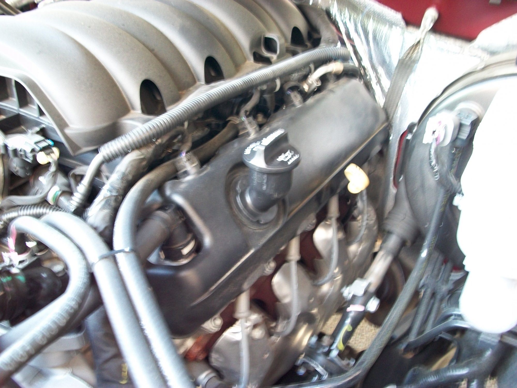

Also adding a filler neck extension to the valve cover will help trying to get all of those eight quarts of oil into the engine and not all over everywhere.

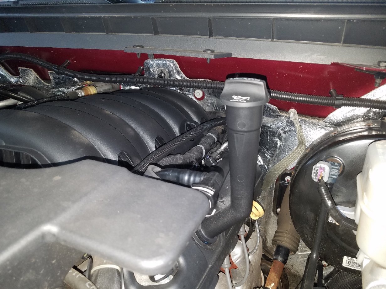

Already ahead of you on this one. My filler tube is longer to make up for the short dip stick.?

Already ahead of you on this one. My filler tube is longer to make up for the short dip stick.[emoji16]
Hey did you have any fitment issues on your long tube dipstick? I had got mine and its loose and doesn't really seal like the shorter one you at mentioned. Figured I'd ask, also what was the part number? Mine didn't have any markings or gm numbers on it, I was wondering if yours was the same

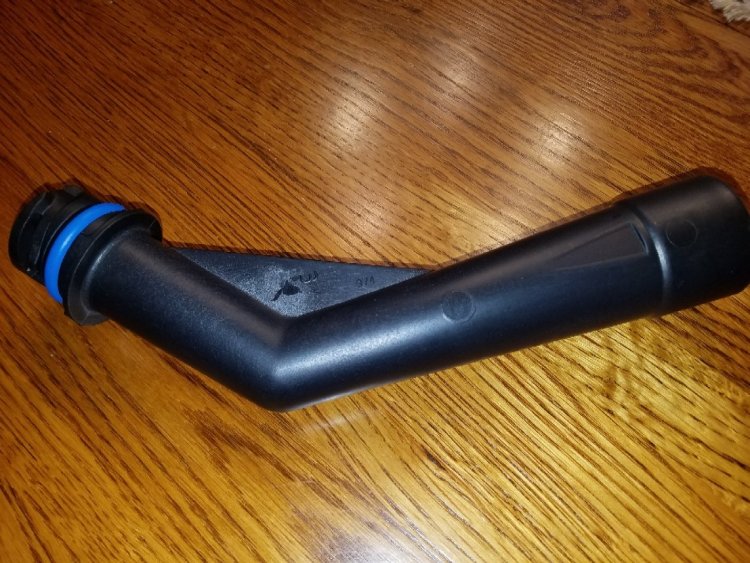

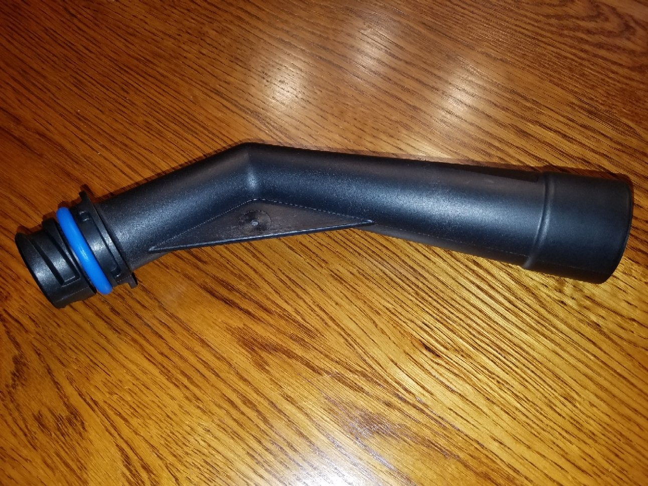

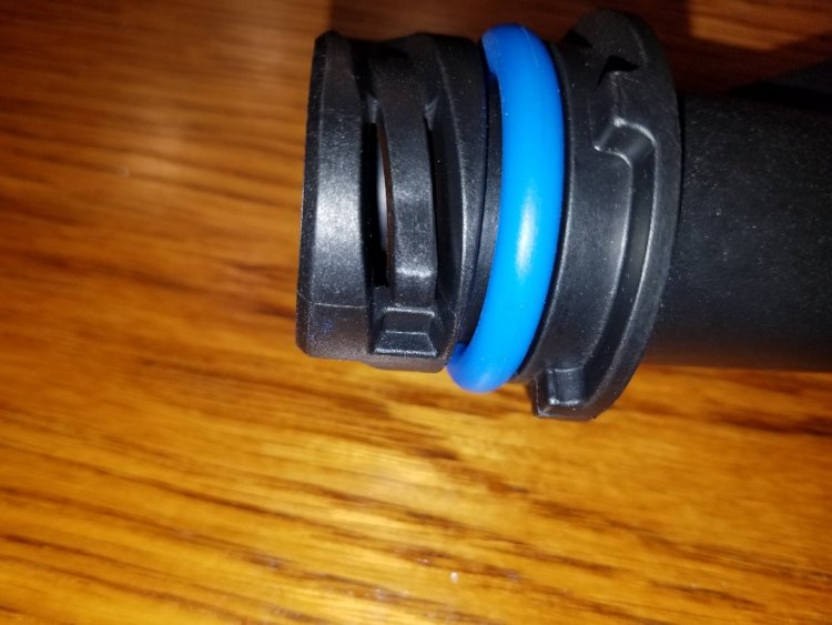

Yes, the "oil fill tube" is somewhat loose/wiggley but it snapped in & I can not remove it now. I do not get any check engine light, so I will assume that there's no air leaking around it. I ordered it here https://www.gmpartsnow.com/oem-parts/gm-filler-tube-12691785
Filler Tube - GM (12691785)

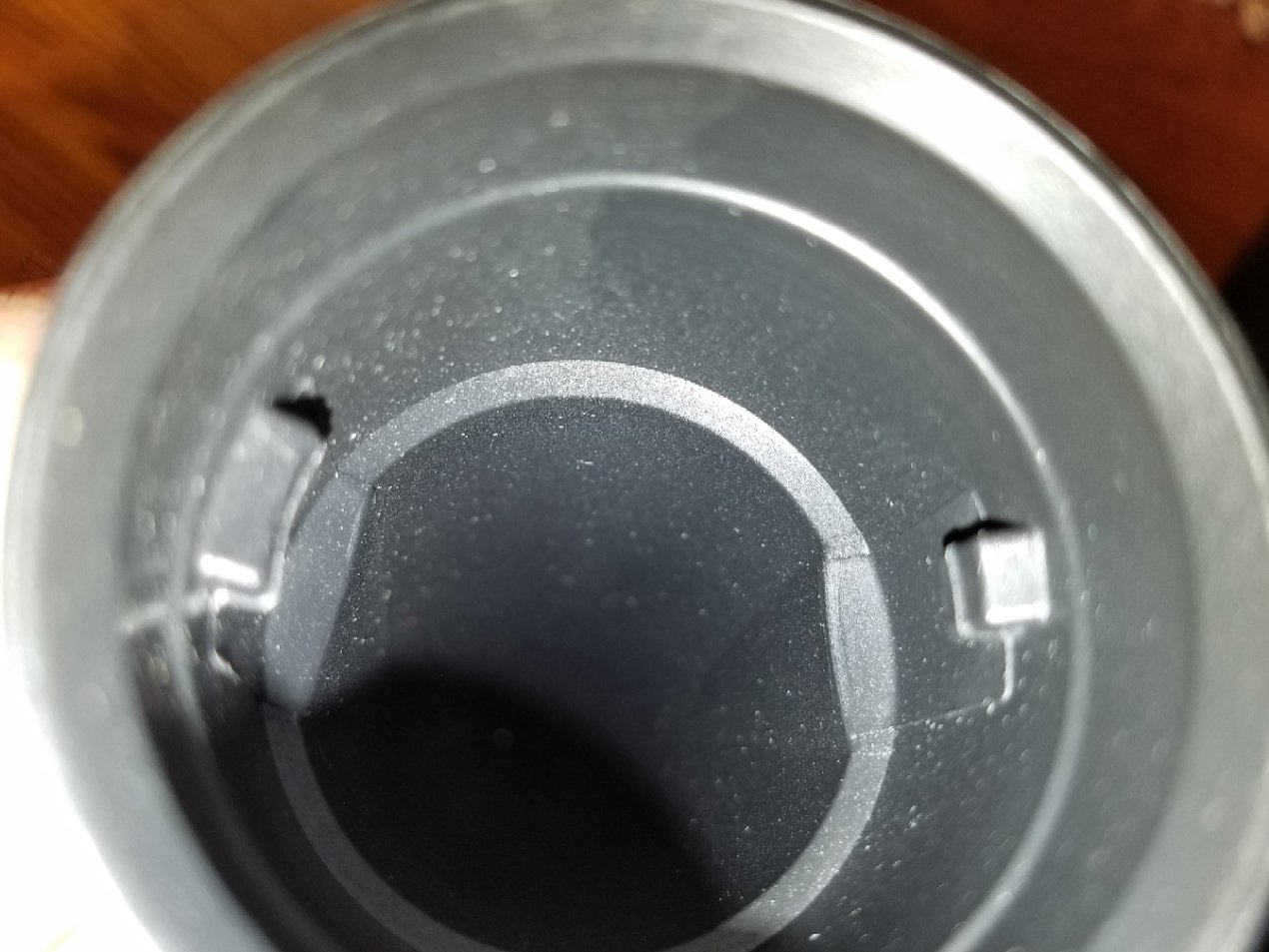

I've posted add'l pics out of the box. You can see the snap feature that locks it in. My existing cover cap fits fine. It would be nice if some on with a '19-'20 Silverado would check theirs & post pictures.

Ah, thanks for posting! Yeah mine snapped into place and I didn't know why I couldn't get it off and I broke off what must have been the lock tab. I'll have to get another one later cause I'm not crazy about how mine sits on the valve cover now. Tha ks for your response, exactly what I needed to know
