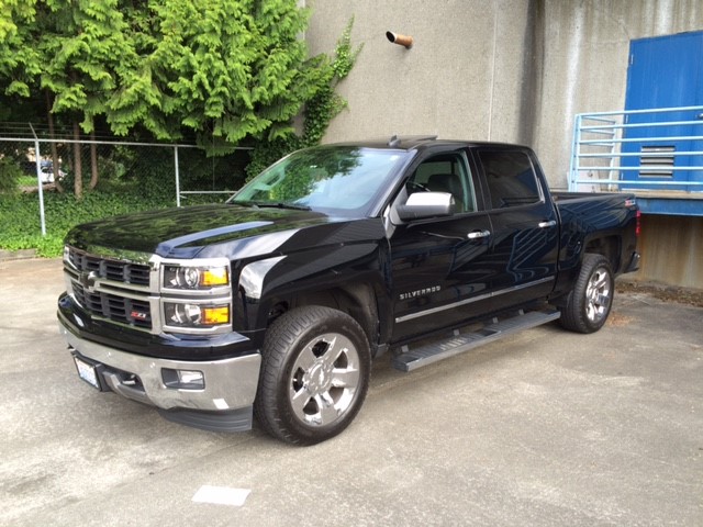

This was my 14, 6.2, 6 speed, and a 3.42 rear end, it was a very quick truck, stayed in the happy torque range a lot better than the 2 8 speeds that I have/had so far.
Remember a Charger R/T trying to pass me at 60, beat him to 90 plus, then let him pass, because I was in a truck, and common sense kicked in?
