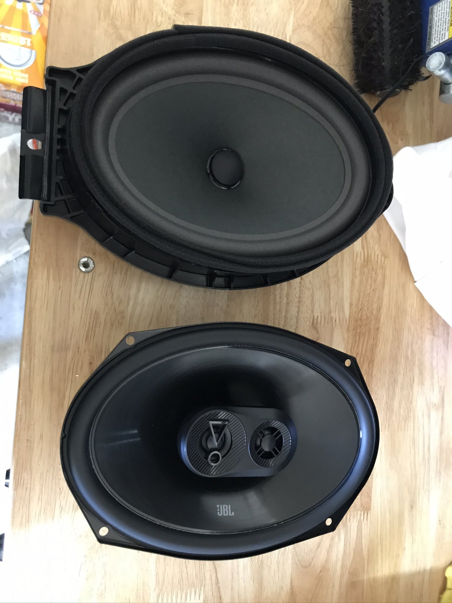

So I installed my JBL concert series speakers...The total install took about 1&1/2 hrs with sprakers brackets and plug a d play harnesses...They sound literally a 100x better than the stock crap without an amp....I have the 8" IOR radio non bose and these speakers made a huge difference in sound...In the speakers with everything for 150$ and was here in 2 days...I highly recommend the Bose Concert series on Crutchfield...They're on sale right now too..

How’s the bass and clarity at high volumes without an amp?
These are the ones I installed. A lot of mids and highs but no lows. Fortunately it’s what I was looking for since I have the factory 10” kicker sub in the back.
