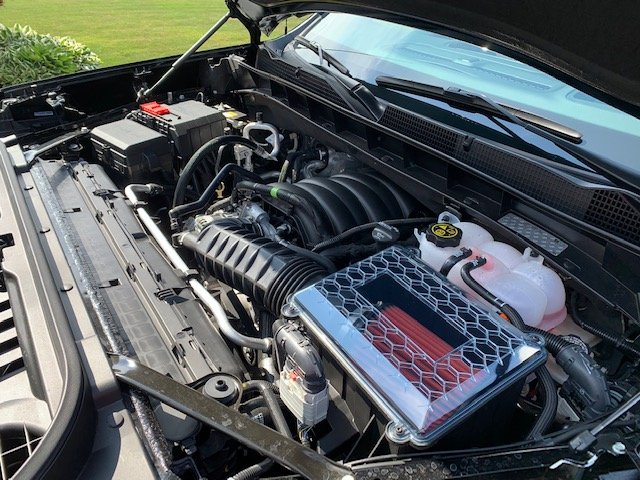

OP, I had the same question and went with the GM product over the Rotofab. I was glad I did when I did the install, as it was VERY easy using the GM product.
The GM does come with a MAF calibration and is obviously 100% warranty safe. On the downside, the dry filter and corrugated intake tube it uses are not optimal for flow.

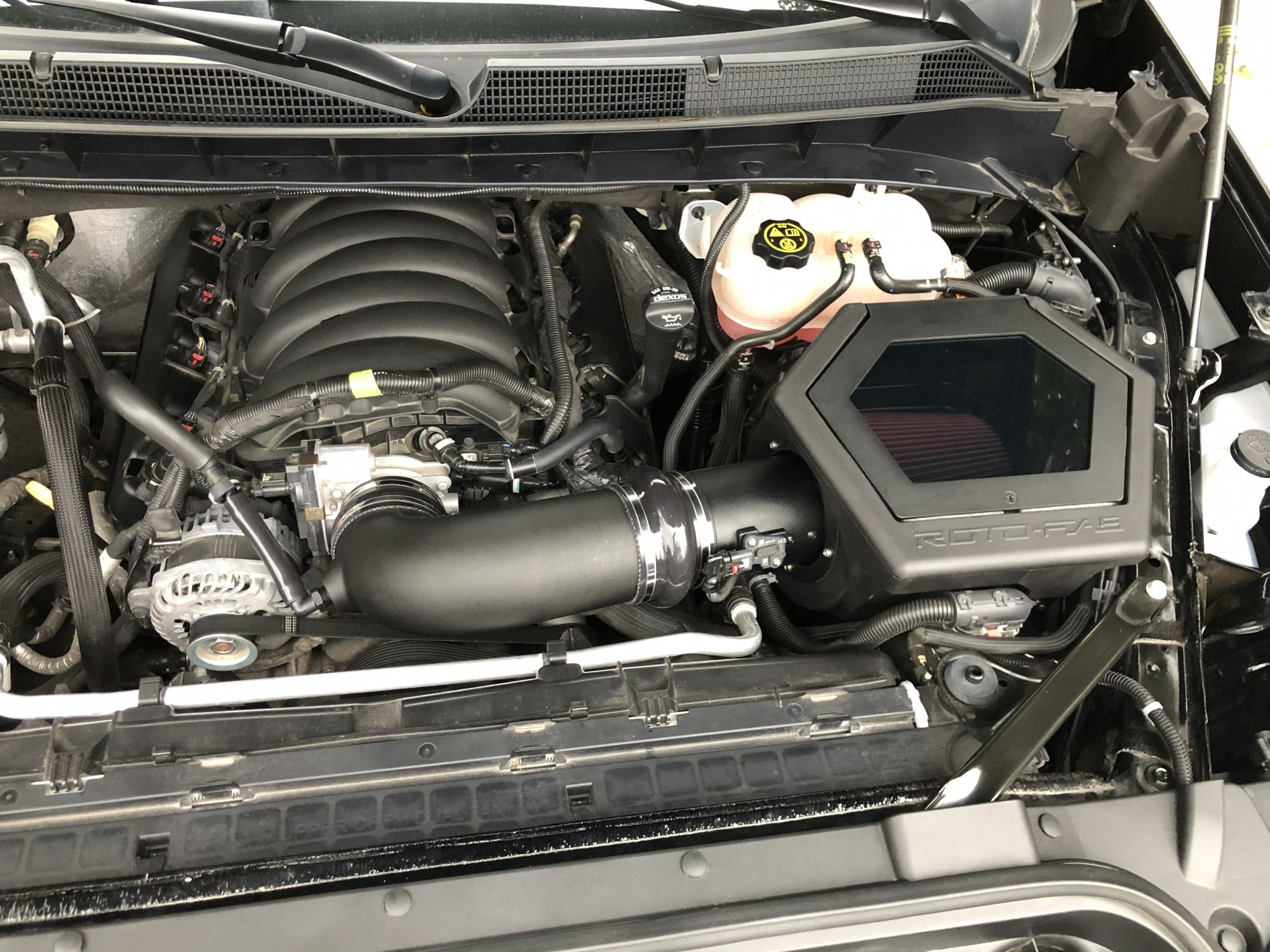

The Roto-Fab plays really well within the stock calibration while still providing nice gains. It is also nicer to look at IMO.
I’ve put about 10k on mine and never had a check engine light, check air filter error or anything else.
I’m sure you’d be happy with either one, just take your risk tolerance for aftermarket parts / warranty and oiled filters into account with your decision.

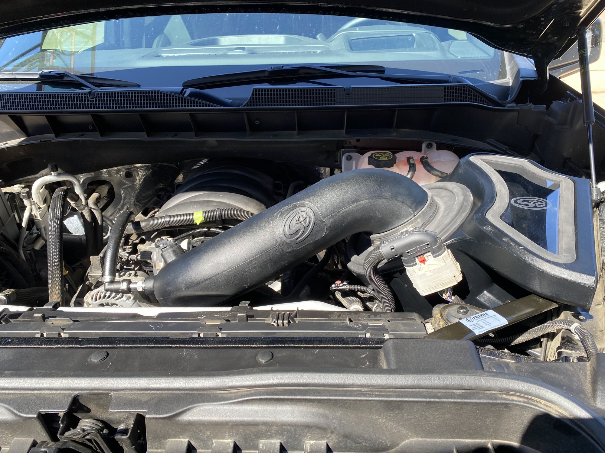

I went with the S&B cold air intake.  Flows more air than GMs CAI and Rotofab. I just installed mine last weekend. This is my second one and their products are very nice.  The filter is massive and when you step on it you can hear it!!  Makes my Corsa exhaust sound even better.
Idk if you can go wrong with any of the 3. I just researched all of them and S&B outperforms them all

I was considering the GM CAI only because of the reflash, thinking that it was doing something for performance.  I have seen the Rotofab make some impressive HP gains on the G8 GXP and SS platform with the LS3.  At a local Dyno Day, we swapped from stock box to Rotofab and and back, same day, same dyno, same temp, fuel, stock cal for both, etc. and it was impressive.  Not saying it the best, but always stuck in my mind that it worked.
If you want an actual performance gain from the CAI itself, I would definitely recommend the Rotofab or SB. The GM CAI isn’t going to give you as much of a boost. It’s a step up from stock, and I like it so far, but I cannot tell any measurable performance increase beyond more sound and more “feel” on my pedal.

All similar, but what i liked about the GM CAI is that it looks more OEM, it maintains the warranty, it includes a slight re-flash and when I had it installed by the dealer, they added it to my truck VIN's factory dealer installed options -along with the performance exhaust.
