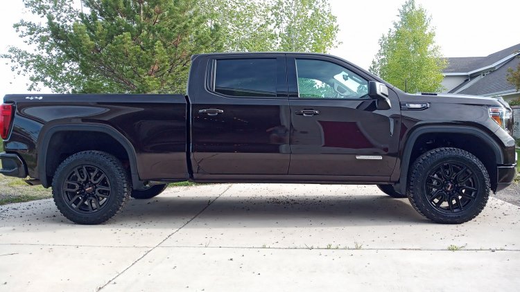

I replaced my alenza's with the 275/60/20 Ultraterrains and I love them!  You might have rubbing issues with the 285/65/20 with no level or lift. Here is a photo of mine.
43 minutes ago, hihosilverado said:
Ken....your truck looks great.  What lift/level kit do you have?
Thank you.  I have the GM AT4 lift.  I also added the Zone 1.75 level kit and UCAs to be safe.  I think this photo is before I added the level though.
