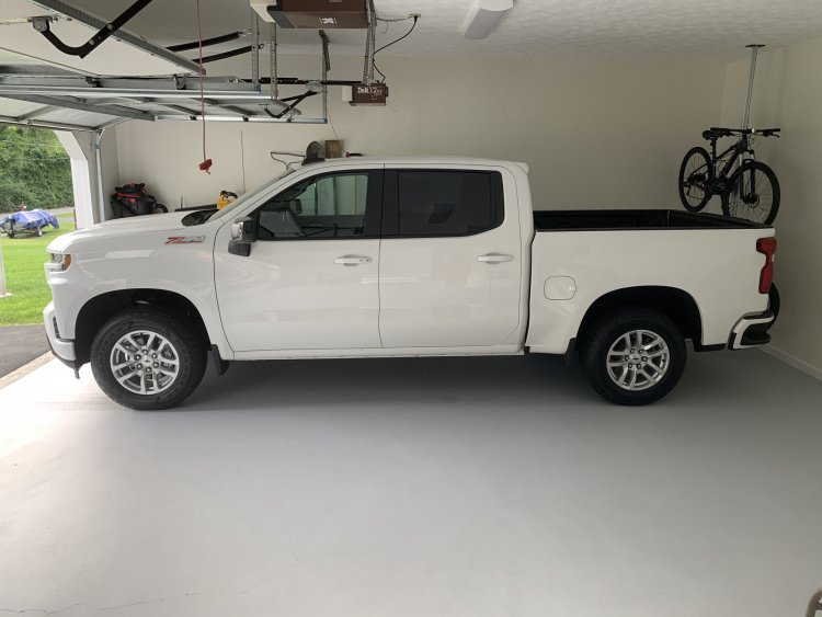

This is how I protect my undercarriage. I just won’t drive it if it’s calling for rain. I drive my Civic to work due to it getting much better gas mileage. I guess I’m to picky but these things are expensive.
What fun is that?  Less safe too, drive that thing, don't save it for the next guy.

That's what I'm saying! Although in my case I have a Lexus RX350 FSport AWD that is admittedly better in the rainy conditions and probably the 1-3 days of snow we'll get here in NC. But I'll drive my Trail Boss in all of that because I just like driving it better.
