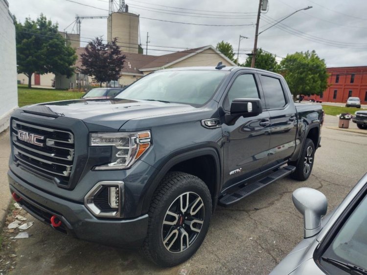

Wow thats pretty low! Mine has been pretty consistant mpg wise since I picked it up. Have you checked it without the computer, hand calculated, to actually see if its off? Did a trip this summer first tank running 70-80mph I was right around 26mpg and next tank 55-70 all around type driving getting 29mpg.  Found my computer mpg was always lower than hand calculated by almost 2mpg at times. Also depends how throttle happy you are but found my AT4 does pretty well overall even towing. Mine has only around 5000 miles on it and hoping it does better the more it racks on more.
Hope you find the cause of yours
