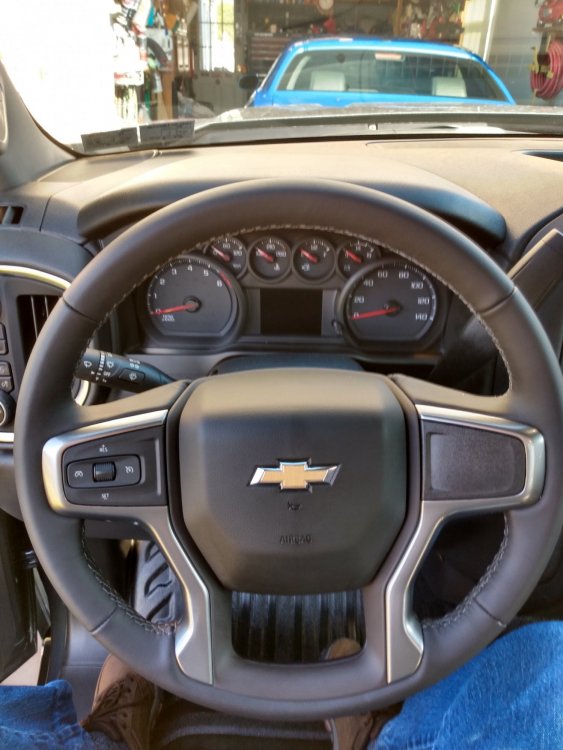

Happy with the wheel swap, now on to my next project, figuring out how to put the chrome trim around the gauges, anyone done that?

Yep, she's done.  Not a tough job at all and I'm very happy with the result.  Many thanks to the Forum members that helped with their experience and suggestions.  It's a nice addition to my Katzin leather seats and relatively inexpensive considering the outcome.

The center bolt takes a Torx T50.  I used an impact wrench to loosen it as it was secured with blue Loctite.  You might have to heat it if you don't have an impact wrench.  If you employ an impact wrench, loosen the bolt in small increments at the lowest setting that works or you'll twist the Torx socket making it unusable.
Edited by Mac-427
One caution after a first road test.  My new leather wheel is beautiful and a perfect match to the Katzkin seats on my 2020 Custom.  Nonetheless, my first drive showed the steering wheel to be very slightly off center.   I concluded that I had reinstalled the wheel one spline off so I removed it and clocked it one spline in the opposite direction.  This caused the new wheel to be off center in the other direction,  so it's going to the alignment shop that I've used for all my rods and customs.   Sorry, I don't trust the dealer to correct such a small change and since I installed the new steering wheel myself,  the issue won't be covered by warranty.  So, even though these steering wheels are supposed to be direct replacements, there are still tiny differences in how they are manufactured.
