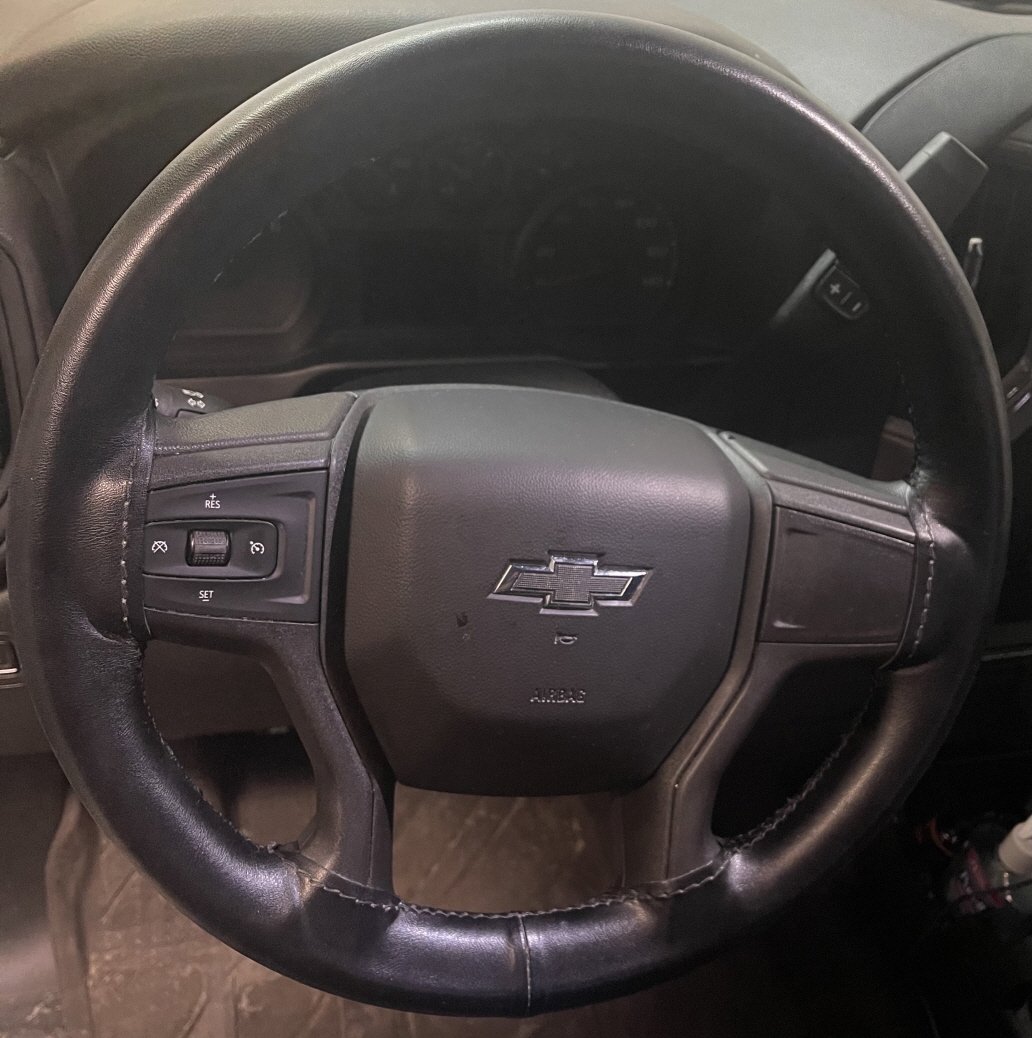

Happy with the wheel swap, now on to my next project, figuring out how to put the chrome trim around the gauges, anyone done that?
What part numbers did you use?
I disconnected the negative battery terminal with a ten millimeter deep well socket.  Very easy to reach.  I waited a few minutes prior to starting the project.  Didn't even lose my radio pre-sets.  I used the following part numbers:  84646079 Steering Wheel and 84649074 Trim Cover.

Yes! Super easy mod.  Installed mine yesterday.  Youll want an impact as noted they do loctite the 50 mm torx. (Counterclockwise to release)  Remove 2 rear steering wheel plastic covers on back of steering wheel.  Remove 2 10mm bolts which release the air bag.  Lift up on little yellow tabs both connectors gently release, release red slide clip on black connector and w light down pressure on clip it will release.  Don’t force any clips apart!  As noted above mine was slightly off but with the electric steering it self corrected to straight when driven from what I can tell.  ALSO!  Make sure to unhook the battery and turn on headlights or push horn to ensure all juice is expended for safety when working with the air bag.
It is a great easy mod and I think it is more perplexing that they didn’t provide a center console that opens vs. a plastic wheel!
