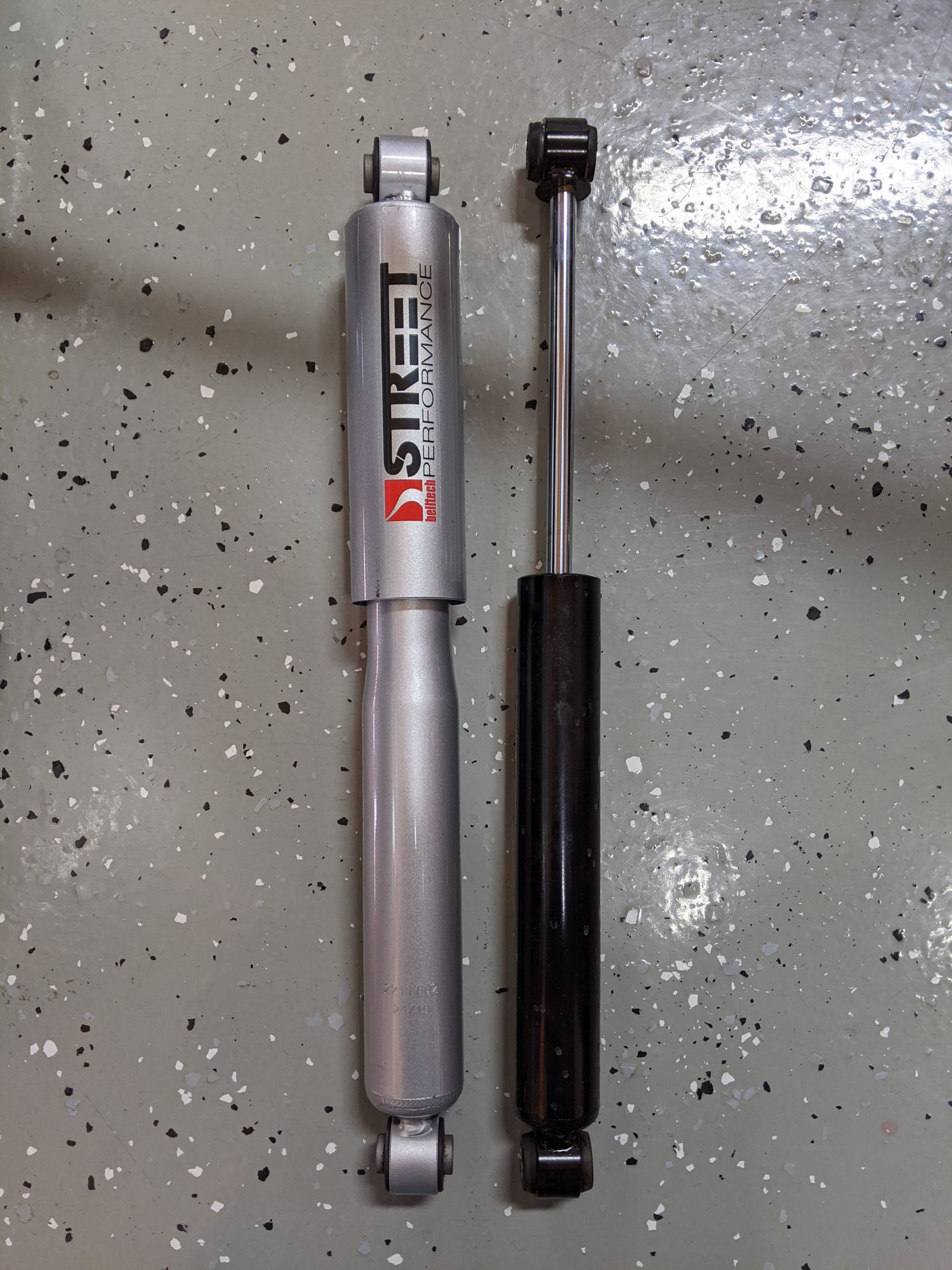

Maxtrac and Belltech shocks side by side, the Belltech has a larger shock body and the collars fit the mounts better:
You just replaced the rears or the fronts too ? How noticeable was the ride improvement ?
So far yes, but I went ahead and ordered the front struts too. The stock front end is way too bouncy. The Belltech shocks are much better than the Maxtracs.
