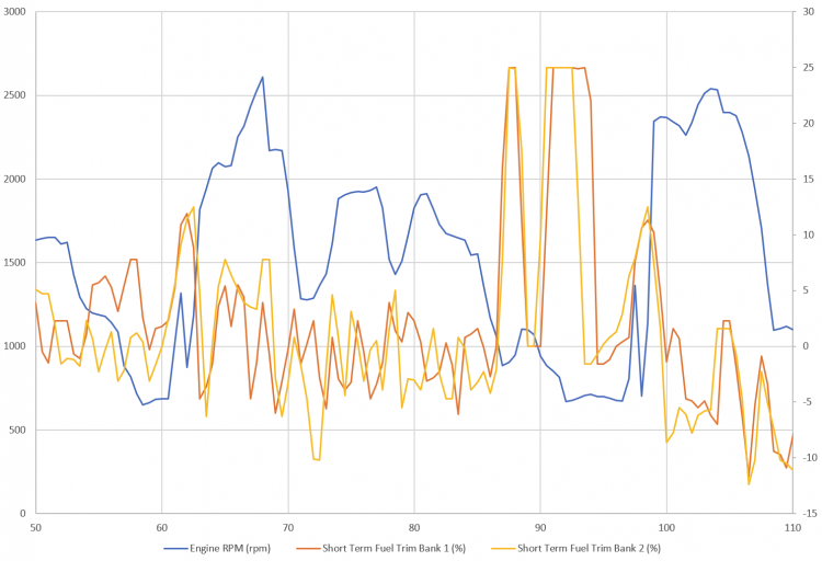

I have taken some snapshots of the fuel trim readings over a time period where there is two hesitations present.
I am going to have to do some research because I don't know what is good for fuel trims.
Long term fuel trims against engine rpm here.
Short term fuel trims against engine rpm here.
Driving steps here. You can see as I start to accelerate from a stop the RPM increases to 1300ish for a split second and then falls to 600ish before jumping rapidly to 2000ish.
This is engine rpm on the left vertical axis and time in seconds on the horizontal axis.
You should be able to map this activity back to the upper two graphs if needed.
Not sure what to do next. The previously listed four codes are still present when I try to read them but the check engine light is still off.
Okay, so I have looked into fuel trims slightly and it seems they ideally should stay even with perfect air/fuel ratio.
Since my STFT is maxing out at +25% that means the PCM is detecting a lean condition short term and is trying to add more fuel.
However, my LTFT is consistently negative at 0 to -14% like the PCM is detecting a rich condition on average and is reducing fuel.
After noticing that both banks are roughly the same acting I believe it has to be something that must effect both sides.
