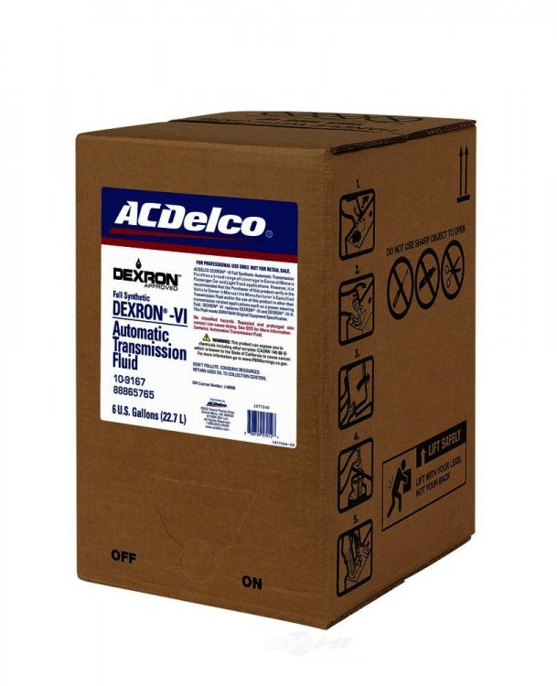

16 hours ago, elcamino said:
Avoid GM/AC Delco at all cost.  If not AMSOIL, then go Mobil 1 as 2nd best.  Nothing but problems with GM branded Dexron in new 6 and 8 speeds.  Contrary to popular belief Dexon is not synthetic and the transmissions perform better with 100% Synthetic ATF.
Dexron VI is full synthetic.
