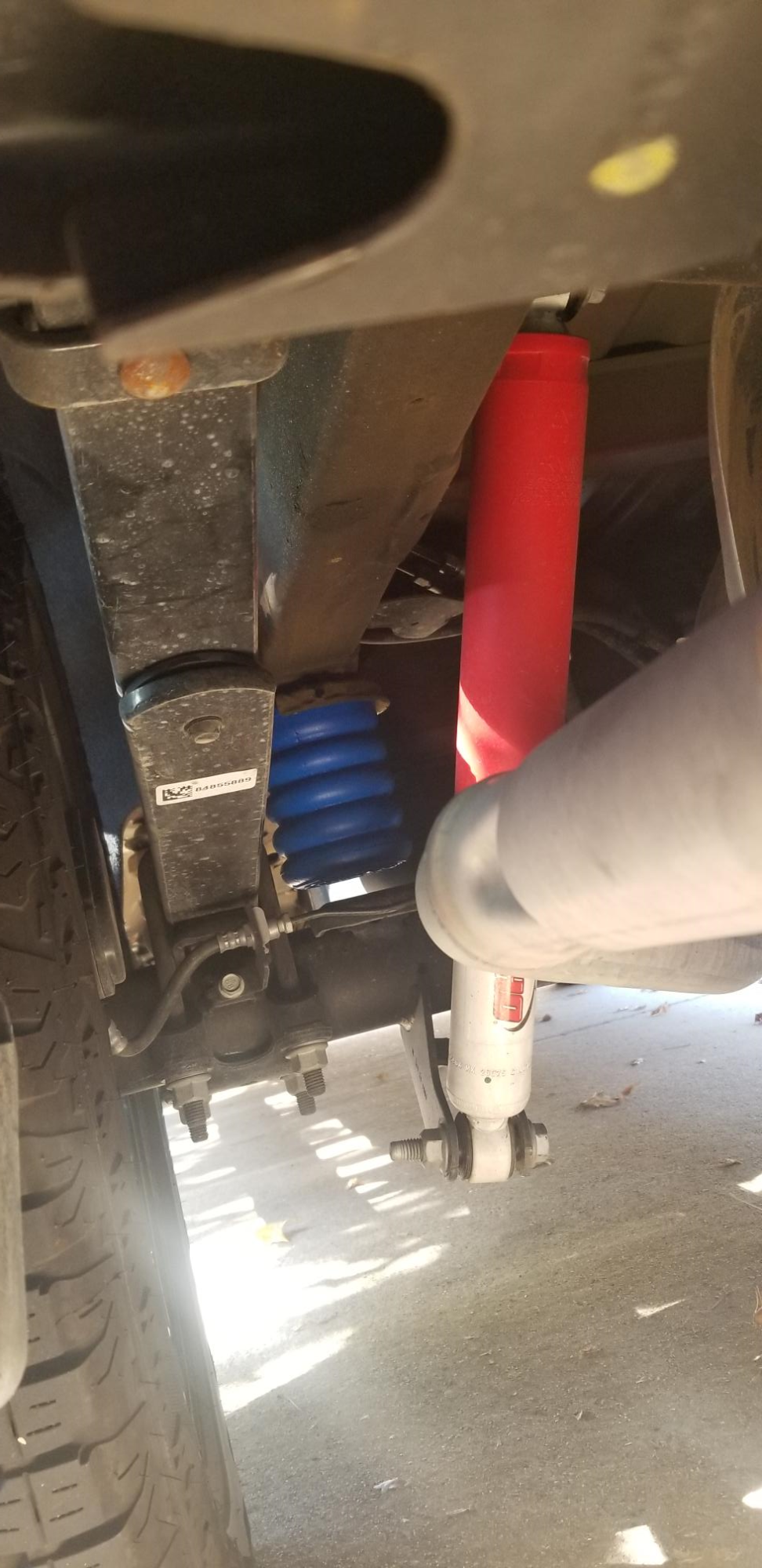

Hello all.  2021 3.0L Duramax X31 Elevation owner.  I am about to take ownership of a travel trailer and will be using a WD hitch (roughly 6500 pounds of trailer with a 700 tongue weight).  Both well within the ratings, but I'll need to be wary of the truck's payload capacity.  I will eventually replace the spongy Rancho shocks with Bilsteins when they wear out, but was looking for something to assist with squat and stability when towing.  I ordered the blue Sumo Springs after researching Timbrens and other options.  Ordered Monday direct from the manufacturer and received them two days later.  They only took about 30-45 minutes to install them this morning, and much of that was chocking the fronts, jacking it up, and placing jack stands.  Huge improvement in the unloaded stability and ride of the truck when going over bumps and on corners - not near as much bounce, and not harsh at all. Anyone else running the Sumo Springs?

Not harsh at all when unloaded because I opted to:
1. Not use the optional 1" spacer that would place the Sumo Spring in direct contact with the axle, thereby only engaging it when there is a lot of movement in the axle.
2. I opted for the mid-level "blue" product rather than the much firmer "black" option.

Agree completely.  I think the best way to explain the ride after installing the Sumo Springs is it rides like I have about 750 pounds in the bed of the truck - it's not floating and bouncing.  Feels good to me :thumbs:.

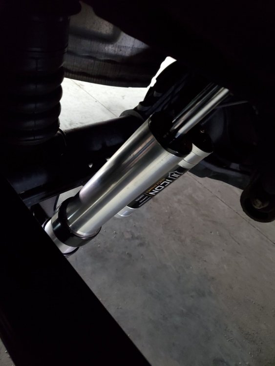

I put the black sumo springs on my 19 2 years ago. They work perfect for what I need.  I have them tho with a spacer but I have a 2 inch rear lift. I have these set about 1/2-3/4 from the axle. Normal driving they don't touch. When I haul a ton in the bed it goes down about 1-1.5 inches. Towing they work perfect, I hauled 3-6k on my car trailer. The pic it looks close to the axle but it's because the pics so dark.
