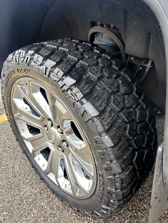

My truck is a K2, and I just put these Cooper Rugged Treks on stock size 285/45. Cooper lists it at 32.36". I absolutely love these tires, I cannot believe how quiet they are for how aggressive of a tread pattern. They have tons of siping for snow too.
