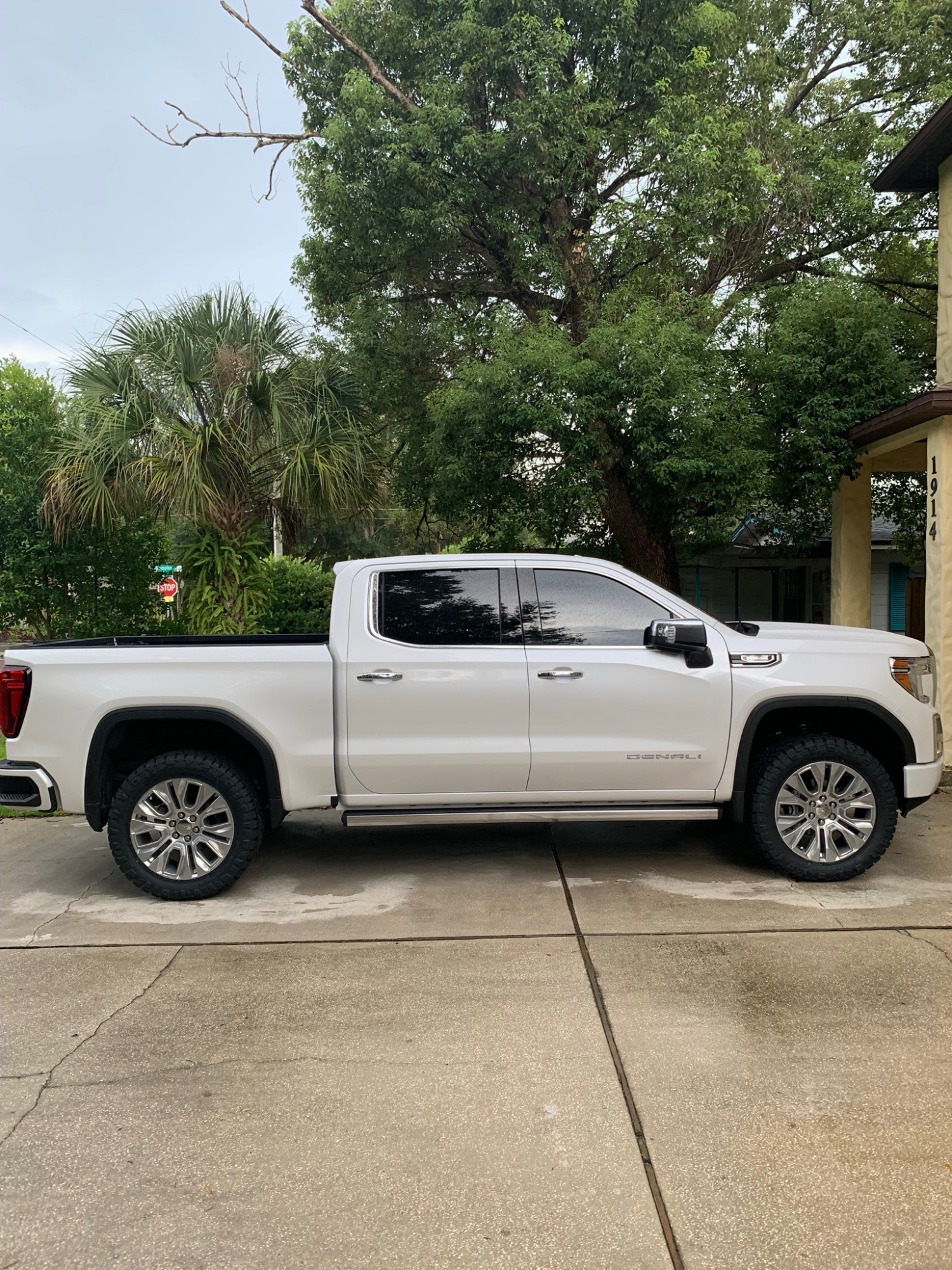

I have 285/55/r22 Nitto ridge Grapplers on my stock 22” wheel with spacers and a 3.5 inch lift and I still had to modify the inner fender and the mud guards for them to fit. I was planning on going with 285/50/r22 (I would still need to do modifications with this size as well) but there were only 2 AT tire options worth purchasing in that size. I did a ton of research before my lift and tire purchase and what I learned is not all tire manufacturers have the same exact sized tire even tho they say “285/55/r22”. They will range from 33.5”- 34.5”. That 1 inch may seem small but it’s the difference between your tire clearing or rubbing in places it should not touch. 285/55 and 285/50 from my experience will not fit a stock height Denali. (I own a 2021 Denali 1500)
