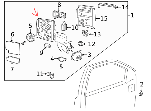

So during the nor'easter I hit a hanging branch that broke my mirror.
The only thing that's broken is the injection molded plastic piece (see red arrow). It's essentially the frame of the mirror.
I cannot find a way to order this piece separate. Just about every other piece can be ordered... but not this one. (That I can find.)
The question is for anyone with experience with these mirrors... Does anyone know if I buy the "cheap" non power version of this mirror will the frame piece that I need be the same?

Check craiglist or local junk yard , for take off . good luck
Don’t know whether the nonpower version frame is different. However, best i can tell the outer frame piece for the mirrors that don’t have the rear facing white lights that light up with the bed light are different from those that do have the lights. They have the same mirror glass shapes with the notch, but the notched area is flat instead of having the light shapes.
