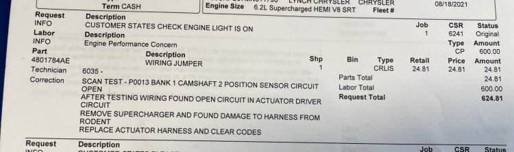

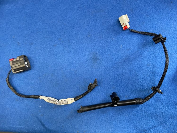

Timely topic. Flippin squirrels got my Ram last week. They left the walnuts in there to prove it. $25 harness, but $600 labor because of course it’s in the valley where no human could reach. Maybe it’s true about the trash because I never had this problem with my GMs.
