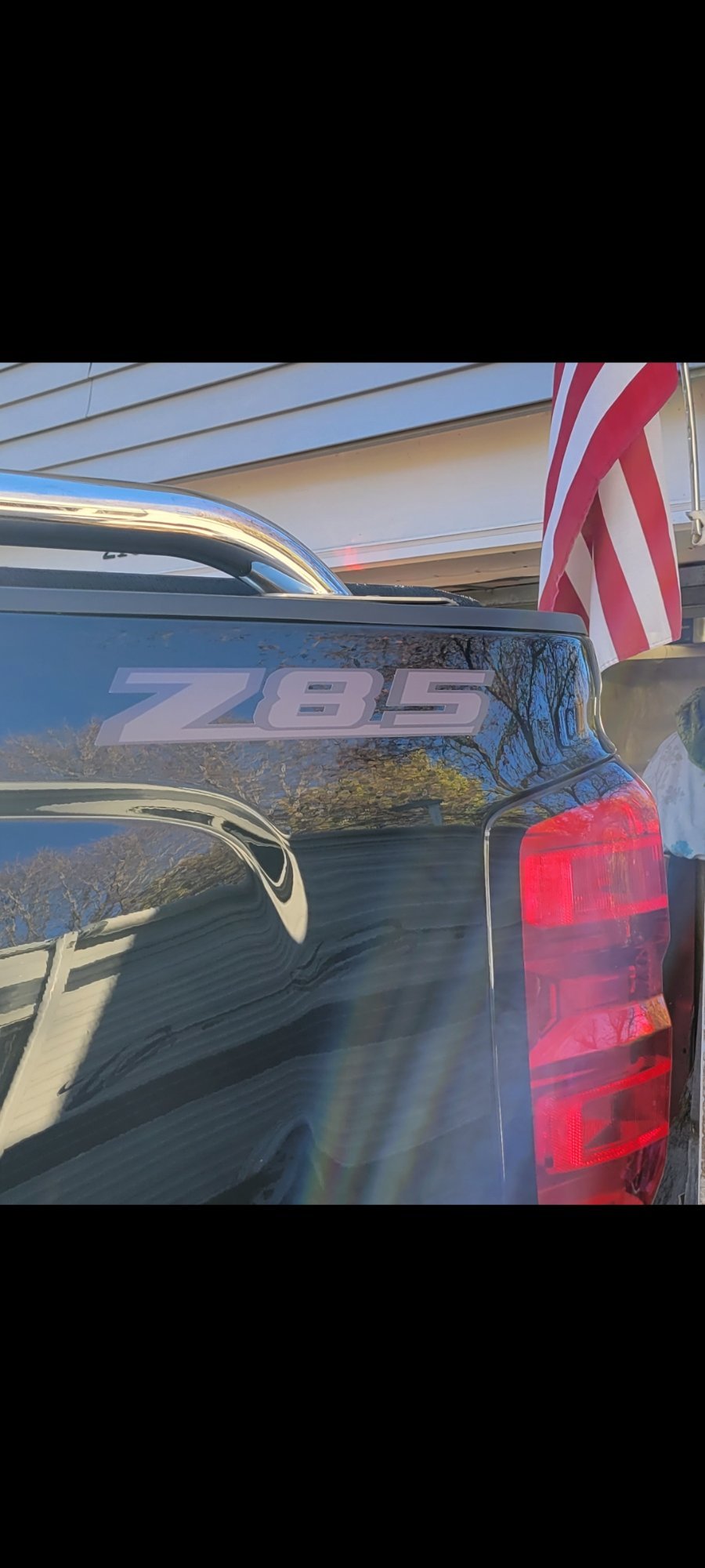

Hi. My truck is a 4x4 but does not have the emblems on the bed. It's not a Z71, it's actually a Z85. But anyway, I bought OEM 4x4 emblems for it but I'm not finding any data on exactly where they are to be installed. Any help - Appreciated.

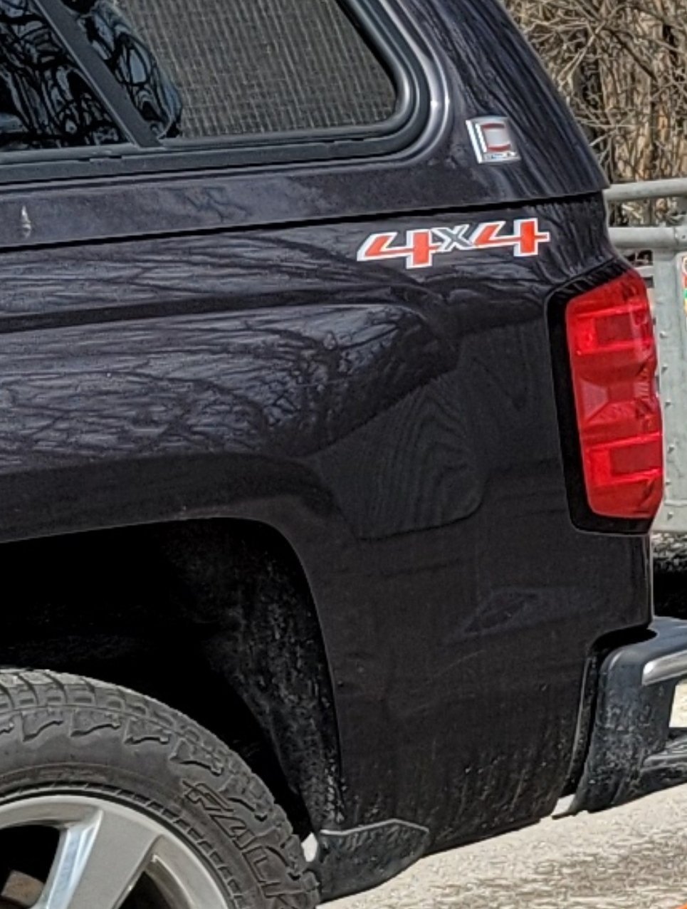

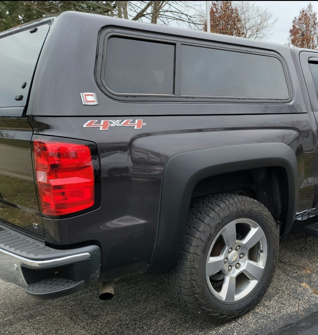

I found this photo of mine with the factory OEM sticker on the right side. Hopefully this will help you. I will try to find one of the left side as well...

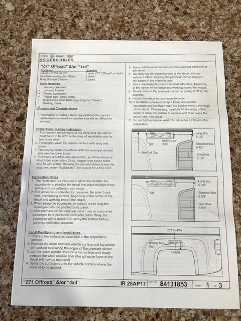

Welcome to the site.
Straight from GM for the placement.
