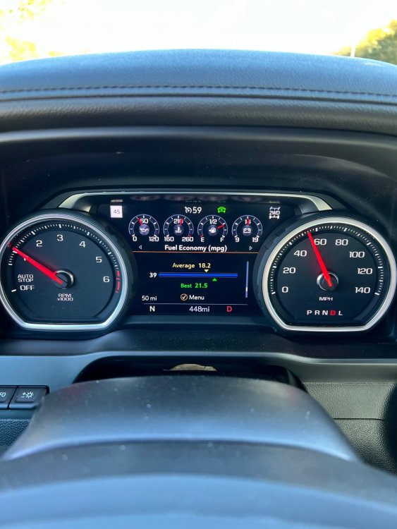

Riding down the interstate today, I saw my temps go over 210. Not just a smidge but Id say a good bit. When I got off the interstate and not going quite as fast it was still high to me. I am used to seeing the temps not go over 210. Is this normal? It was a balmy 61 degrees. Also, stopped at a light, it looked like the oil pressure was sitting about 25. Is this also normal? Thanks in advance.IMG_2901.thumb.JPG.1509173f2d460257e34795f42bb69a62.JPG

All normal, mine runs the same temps year around as to the oil pressure also, pressure goes up as engine speed increases nothing to worry about

Ok awesome. It just seems so out of the norm to go over 210. I mean 210 seems hot as it is but even higher is crazy. Not to mention oil pressure going to 25. Thanks for the quick response.

I wonder if the grille shutters weren't opened all the way for whatever reason.  I'd get a nice bluetooth OBD like OBDLinkMX+ and the Torque app or OBDLink's app that way if you see this again, you can read actual coolant temp from the ECM rather than the dash gauge.  For example, the 2020 I'm driving at work to set readiness monitors, the gauge reads "210" but the actual ECU coolant temp is like 195-200.

Uh.  That gauge that is just over 210 in OPs picture is engine coolant temp, not trans temp.

So its normal or not normal? My trans temp was about 167-169 when this was going on down the interstate etc.
My 22 LTZ like yours runs a tick above 210.
Mine has more oil pressure though. Running down the highway at 70 its about 55-60 lbs.
At a stoplight it goes down to around 35-40 lbs.
That is perfectly fine for the trans temp. It will fluctuate up and down, depending on driving conditions and weather. That is not hot by factory specs.

I knew the trans was good. Was just pointing out what it was. The temp gauge was reading about midway between 210 and the next hash mark. I just ran it back down the road about 50-55 and it was just a bit over 210. I did have the Pulsar LT on it during the drive home. Not sure if that had anything to do with it mind you but I pulled it off when I lost 3MPG. As much as I love it being a V8 all the time, I dont want to loose that much. Not sure whats up with the 22s but the 21 Sierra got 20 easy with no DFM. Cutting this one off it dropped for 20-21 to 17ish.
@dieselfan1As for oil pressure, Mine running down the highway is about 50-55. The 21 Sierra was about like yours is now which is about what I am used to.

So, I guess we are gonna go with its normal. Ill stop worrying about it then. Next up, figure out what exhaust to put on while keeping DFM.

Talked to service department today. Apparently 210-225 is normal for this truck. Apparently the fans do not even kick on til 225. Funnier though that it runs that hot running down the interstate but in town it sits just above 210. I did throw my handheld on it and it idles about 215.6. Sure does seem hot to me but I guess there isnt much I can do if they programed the fans to come on so late.
