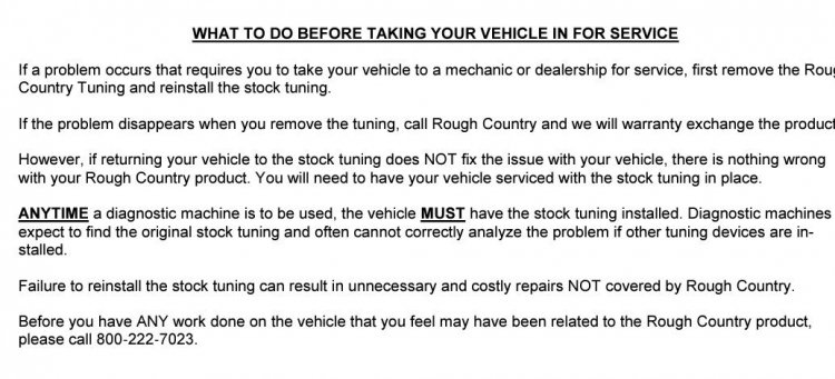

They list in the description that you can return it to stock before being serviced, so I assume that means however they are making the changes must not leave a trail. So I'd just do as they say, return it to stock speedo settings and bring it in.
I guess I should have taken my own regular advice and RTFM for answers. You are correct and it tells me to return to the factory programming before service.

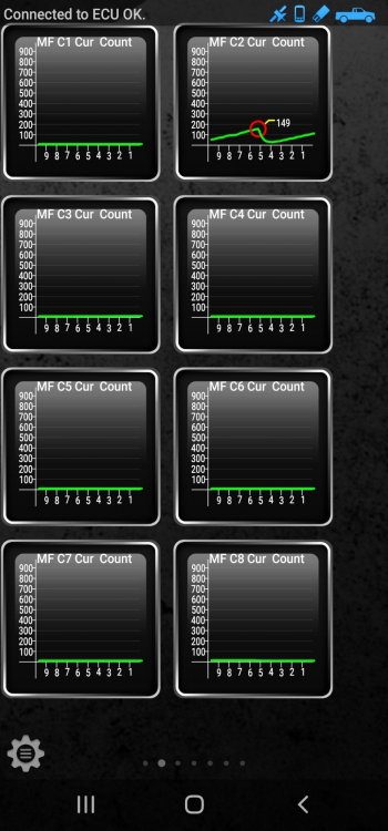

Quick update, I forgot on my Torque Pro app, I set up 1 of the screens to monitor current misfire conditions per cylinders. I put the key into run on a cold engine but didn't start it. I let Torque Pro connect to the reader first and then started the engine. It showed misfires on Cylinder 1 but, it peaked once and then smoothed out after the initial misfires. But it also showed many more misfires on Cylinder 2. This lasted about 20-30 seconds. It peaked several times and then smoothed out as well. Once it did, the idle was normal.
Surprisingly, it didn't set a P0302 code along with the P0301 even though it seems there was a bigger misfire problem on Cylinder 2.

Not really surprising, as the DME uses acceleration of the crankshaft on the power stroke (per data from the CkPS) to code a misfire.  Misfires on adjacent cylinders, both in the firing order and sharing crank journals, can trigger misleading misfire codes, even on old-school power balance tests.
While you're waiting for the dealer, ever due a basic spark plug and wire tune-up?  Swap coils between distant cylinders to see if the misfire follows?

No I haven't tried that. I have seen that advice in several threads to diagnose it. The hard part is that this only happens at very first start when engine is cold. If I shut off and restart immediately, no misfires. So I would have to do the swap before the very first start otherwise I would gave to let it sit until the following day to retry. I figure I have the GM Protection Plan and already have the appointment for Thur so I will let them diagnose it first and see what they find.

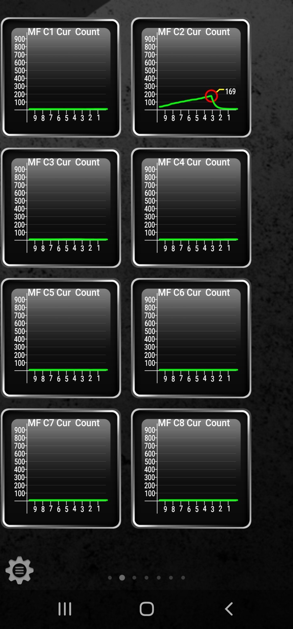

Just to follow up, I have regularly started getting the Torque Pro app and Bluetooth reader active before starting and 2 days ago, besides the code and also several misfires on Cyl 2, I now saw a bunch happening on Cyl's 6 and 8 as well. This lasts only for about 10 or 15 seconds on a cold start and results in a rough idle. It smooths out and then the misfires dont happen again until it sits for a long time, usually an overnight cool down. I keep it running while driving and never see any more activity. It runs just fine after the initial 15 seconds

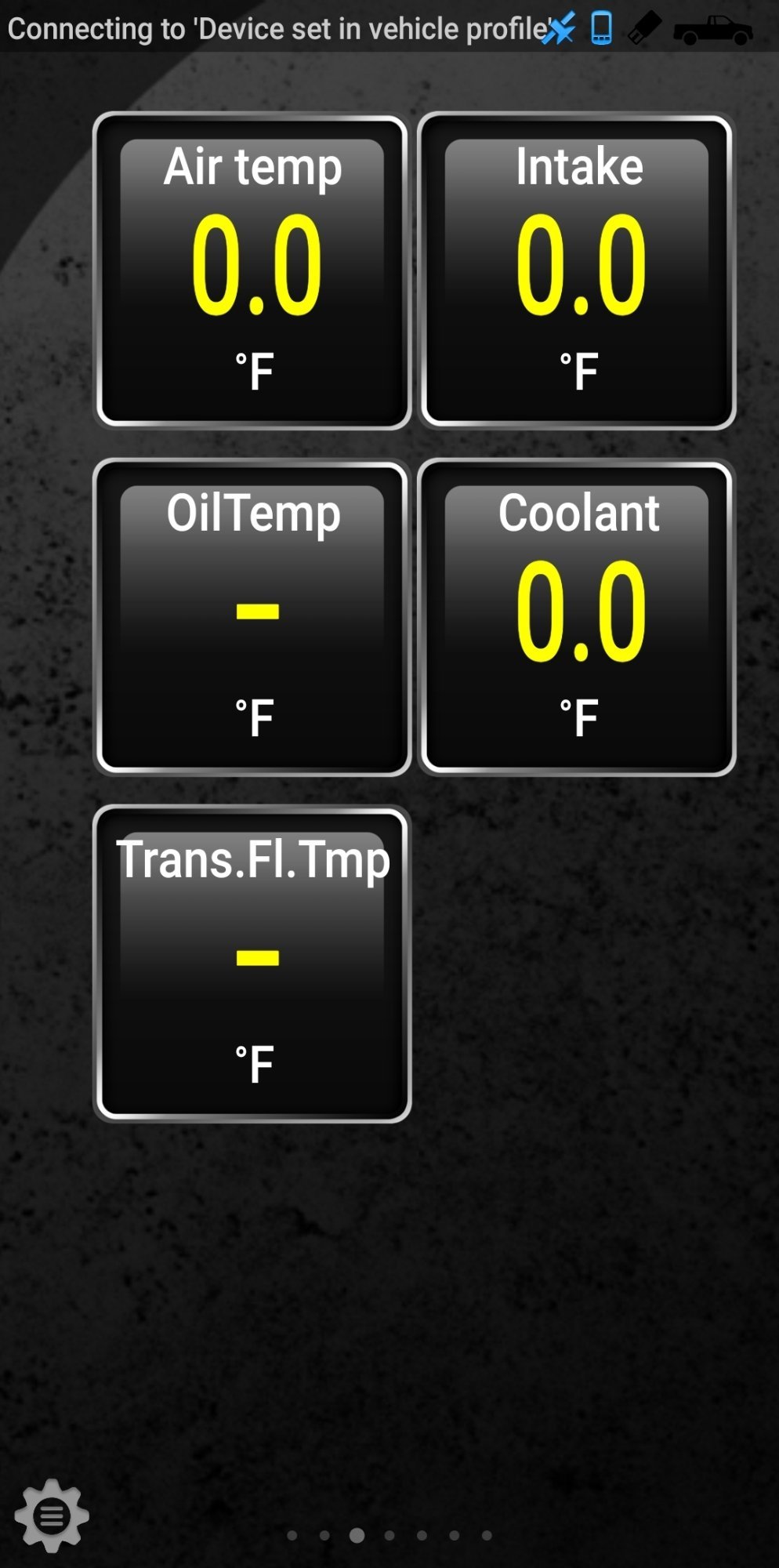

I am using the Android version. It seems to work OK. I did have to add the predefined PID set for GM as the generic PID sensor monitors weren't all working. It's interesting to monitor things in real time like the coolant temp and see that the dash gauge is even more generic. The actual coolant temp can have a 20⁰ swing either way before the dash gauge moves off 210⁰. With Torque Pro, I know right away if temp is rising which has come in handy when pulling the toy hauler. I have found that the Trans Temp in the DIC is actually spot on and much better than the Coolant gauge. But I also like being able to monitor more stuff than the dash gives me. Plus the ability to clear codes to see if they come back up again. Screenshot_20220608-092845_Torque.thumb.jpg.e665b90a00fd683bb0c3300ab0b62577.jpg
This is my most used real time screen for monitoring things.

Your misfire on #2 falls off a cliff, so I wonder if 1) the misfire actually stopped or if 2) the misfire threshold was reached for the DME to stop injecting fuel to that cylinder at that time.
The misfires will peak about four times and then level off and stop. Rough idle while it's happening and when it stops, I get a smooth idle for the rest of the trip with no more misfires. But surprisingly, I only get the P0301 repeatedly and not a P0302.
