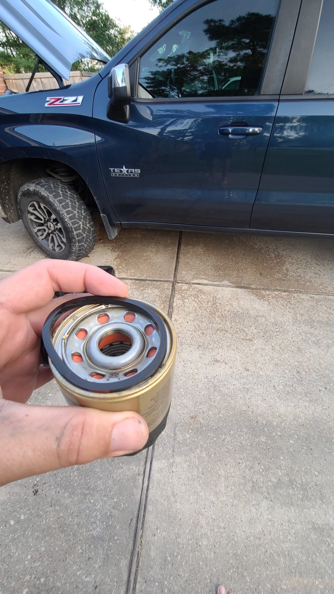

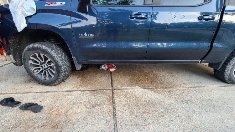

I was changing the oil yesterday and as I was threading the new oil filter onto the engine I thought "Hrmmm, this feels kinda funny, but OK".  I tightened it according to my usual procedure of 3/4-1 full turn after gasket contact with the engine block and proceeded about the business of filling the truck up with the required volume of oil.  After completing the oil fill process, I reached into the truck while standing next to it, put one hand on the brake and used the other hand on the push button start.  It started up and ran just fine for about 2 seconds, then I hear what sounds like a water hydrant spraying and feel oil shooting all over my lower legs and feet.  I quickly shut it down but the driveway beneath my truck, my legs, and the bottom of my truck are COVERED in oil.  I remove the filter only to find that the rubber seal from the old filter never came off the engine block, and I basically installed an oil filter with two rubber seals.  Obviously the "double seal" method didn't work out and I'm a dumbass for not checking to make sure the old rubber seal came off with the old filter.  So word to the wise, make sure y'all check to see that the oil filter seals come off with the filters, don't be an idiot like me.
I couldn't count how many oil change services I have completed at the house and I still made this stupid and silly mistake.  I'll quietly collect my Dumbass of the Day award and go sit in the corner now.
PS.  in the image of the truck only, you can see the one dry spot on the concrete next to the driver's door, that's where my feet were when I turned on the truck, lol.

Good thing your driveway is concrete and not asphalt, should make clean up a little better lol.
I've been doing the basic maintenance on all my vehicles for years. Only once have I ever had the seal stick to the block and not come off with the filter, but it does happen. Must check every time!
look on the bright side, you'll probably never do that again 🙂
