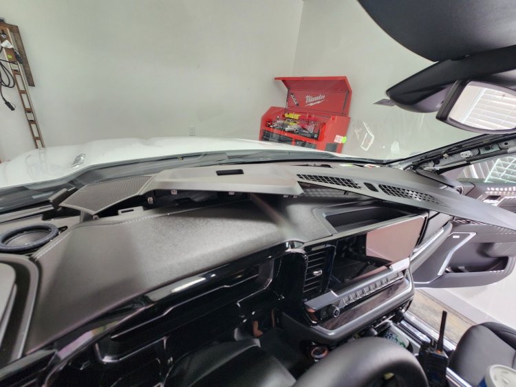

The dash speakers are super easy in the refresh compared to the 19-21 trucks.
In my 2022 refresh with Bose, the front door speakers are 2 ohm while the dash and rear doors are 4 ohm.
If replacing your dash speakers, there isn't a wiring adapter available. The driver side + wire is the blue with purple stripe. The passenger side+ wire is the white with yellow stripe. I used the PAC BB-2PR 600hz at 4 ohm bass blockers on the dash speakers.
To get to the dash speakers in a refresh interior, both A-pillar trims have to come off, then the speaker trim will pop up. The grills are connected to each other by the panel all across the dash. It pops up really easy. The HUD or Driver Alert trim comes off with it. There is enough wire that you don't have to unplug the Driver Alert light. See the picture for reference.
Just an FYI for those interested.
