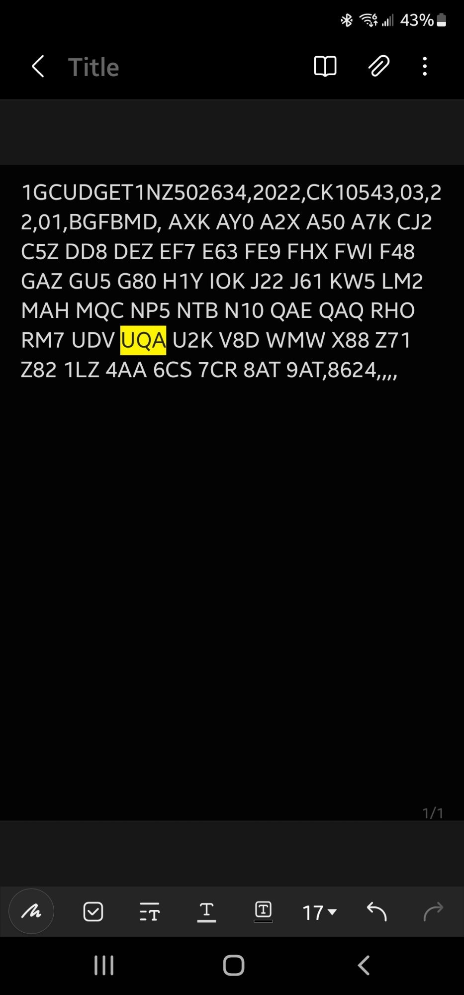

My refresh Z71 LTZ has the 7 speaker Bose (sub being 7th speaker).  It's code UQA Bose 7 speaker premium sound which is standard on the LTZ. This 7 speaker system is available with the RST and LT Trail Boss ONLY with convivence package II.  I have good bass from the center sub.
Where is the sub located? I don't have 7 speakers on my refresh LTZ and I have the UQA code. I have almost zero base from the stock Bose system.

Must be a AT4x and Denali Ultimate package then. The other trucks do not have a sub.

Man I have plenty bass.  I'd say it's the center console because when my doors are open I still get good bass in the cab. If you have the UQA Bose then it's 7 speaker otherwise it's 6 speakers.  2 dash, 2 front and 2 rear doors.  The 7th is the subwoofer.  What sub model truck do you have?
I've got a LTZ. This picture is from scanning the QR code on my door jamb. There is no sub in my center console. I've had it apart and been under it. The Bose in my 2020 RST had a sub in the center console and sounded good. My 2020 Equinox does not have a sub but puts out excellent bass from the door speakers. The 7-speaker system (3 in the dash) in the Equinox has put done the 2021 AT4 I had and my current 2022 LTZ refresh.
The sound outside the truck is different from inside, before and after changing the speakers. I will generally roll the windows down and listen to the stereo from the truck if I'm working in the garage. It does sound different (better) outside than in.
That's weird.  The 7 speaker UQA Bose is standard on the LTZ and there isn't a 3rd dash speaker.  I ordered mine in Dec. and the build date was March.  Wonder if they stopped putting them in? When was yours built?  Like Sclemmer said, mine hits pretty hard as well.  IDK.
Mine was built in late March. I bought it in early April.
I'd like to see a picture of your sub, if one is installed. You can get under the center console pretty easily by pulling one of the side panels off it.
I've been in a couple HC's that sounded exactly like my LTZ audio wise.
